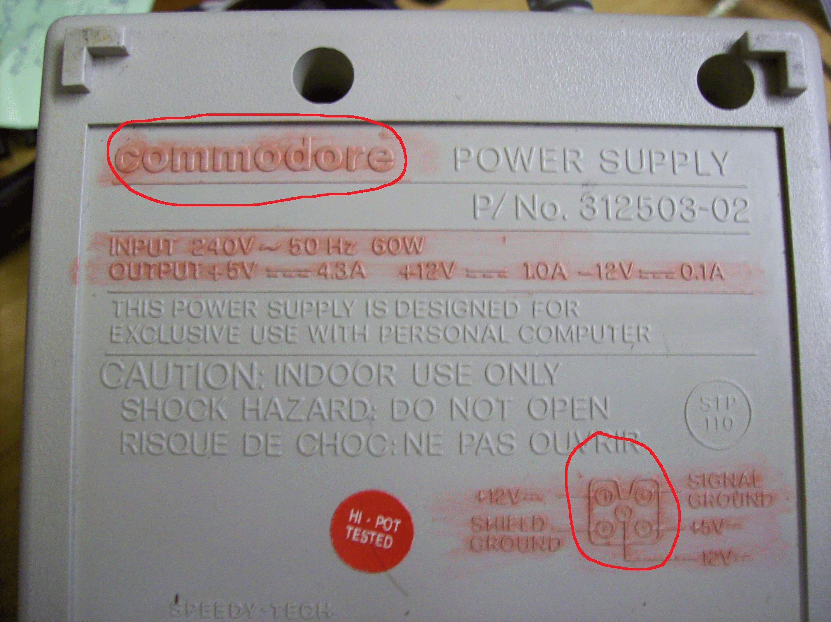

The PSU with square plug is for Amiga - the C64 PSU has round plug
Smart-ass fail. Commodore made PSUs for Amigas, so what? It’s still a PSU for an Amiga.
If it says commodore on it and was advertised as a commodore it is a commodore…so sayeth the markings ![]()
It is.. because it was Commodore who made Amiga. They also made C16, VIC20, Plus4, PET and a ton of other machines too..
Apart from that they also made pocket calculators and wristwatches - a little background on Commodore http://en.wikipedia.org/wiki/Commodore_International
Amiga PSU http://amigakit.leamancomputing.com/catalog/images/amiga-psu.jpg
Commocore 64 PSUs http://jope.fi/cbm/cbm/c64psu.jpg
Amiga PSU has 5V and -12V/+12V with square plug http://www.hardwarebook.info/Amiga_500/600/1200_Power_Supply
C64 PSU has 5VCD and 9VAC with round plug http://www.allpinouts.org/index.php/Commodore_C64_Power_Supply
