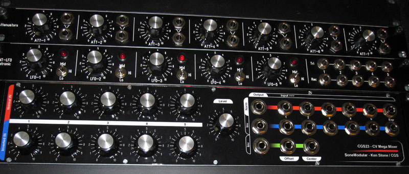

Alternative front-panel from aluminum dibond
“Aluminum Dibond” is a sandwitch of Aluminum-Polyethylene-Aluminum.
Salierdruck prints full color photo quality prints on it and laminate this with an UV and scratch resist foil.
You can “paint” your design with PS or any other gfx prog in 1440x720dpi.
It’s really cheap but you have to do all the drilling & CNC work.
Take a look at Salier Druck
(Maybe you have a similar online seller in your country.)
And here is a finished example from Frank Makowski. Thank’s Frank!
