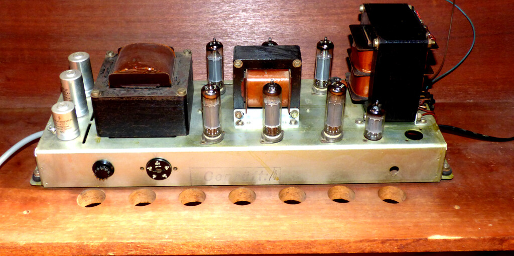

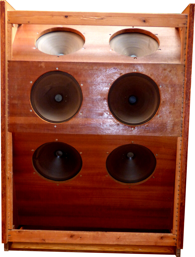

I got an old organ “Ahlborn C33” made around 1960’s. There are two manuals and pedal (and 33 stops). The instrument is functioning, but it was in very poor condition. Many of the keys did not work, some stops were not working, and the amplifier and speakers were outside the organ, because there was no room inside. The organ had about 200 ECC82 (12AU7) tubes and associated electronics that served as oscillators.
Here are a few pictures of what they look like:

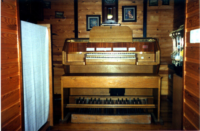

I don’t have old picture of mine working, but this is the same organ (without speaker boxes).
