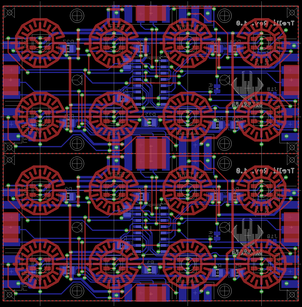

Here is a picture of the layout:
So if you want to use the upper 8 and the lower eight you have to bridge J1A and J2A and leave J1B and J2B open. If you want to break it and connect another of those boards to the right, you have to bridge J1B and J2B and leave the other two open.  I just noticed it misses one jumper. If you want to add a board to the right, you now need to manually solder a wire from the input of J1B at the top to the output of J1B at the bottom. This needs to be changed in the next revision.
It was necessary to use SMD parts for the whole design to make it fit. The connection of the boards is made through edge-SMD-pads like in the original design. To make it more stable there are not only connectors for the digital signals on the bottom, but also some bigger pads on the top. This should give it enough strength.

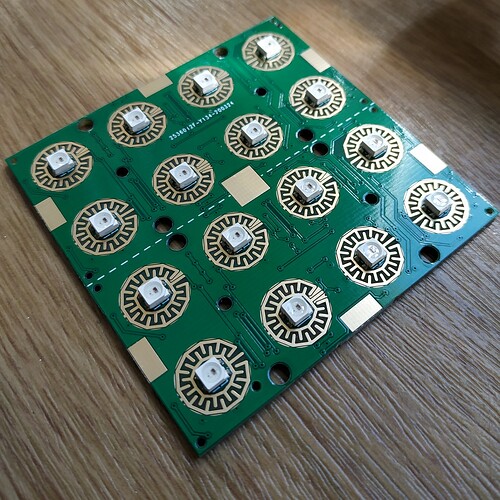

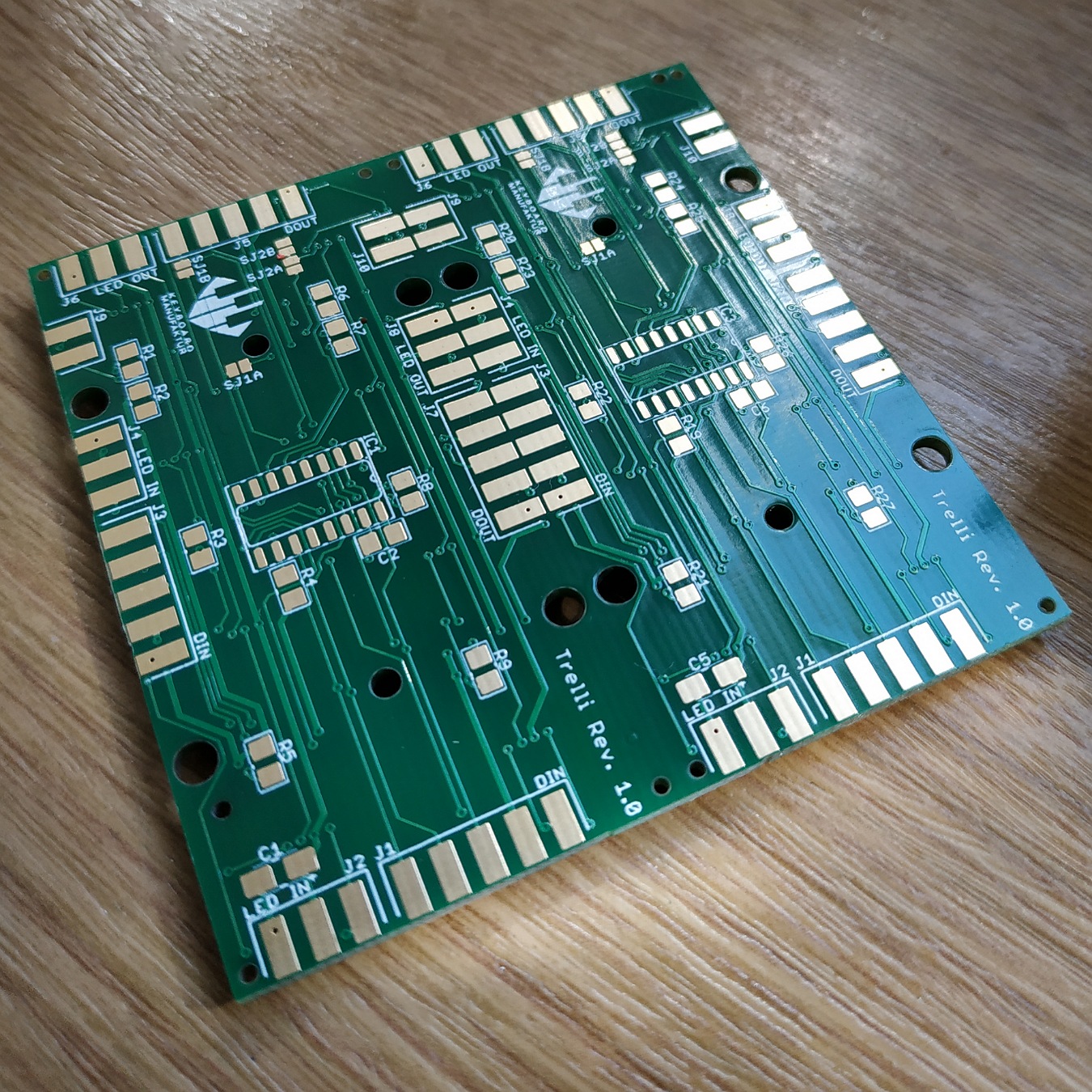

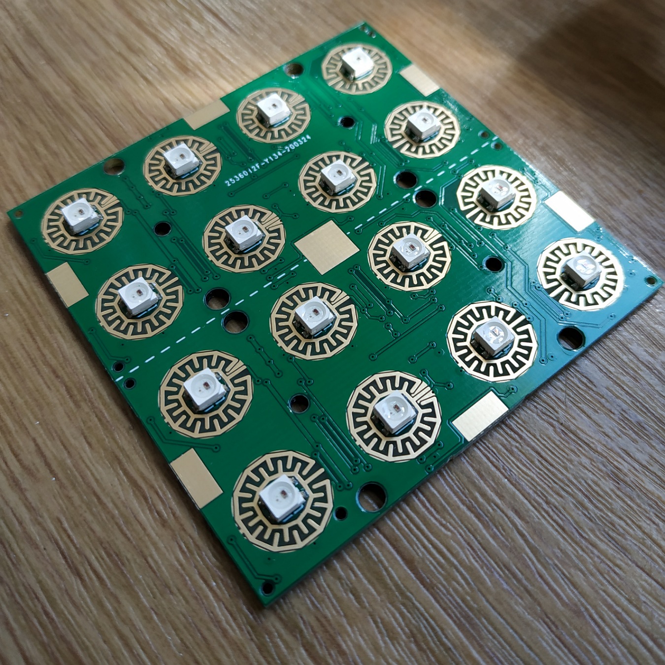

Here are the PCBs. I will do some tests tomorrow and let you know.
I also have done a rerouting of the whole thing to make it cleaner. Looks good so far.

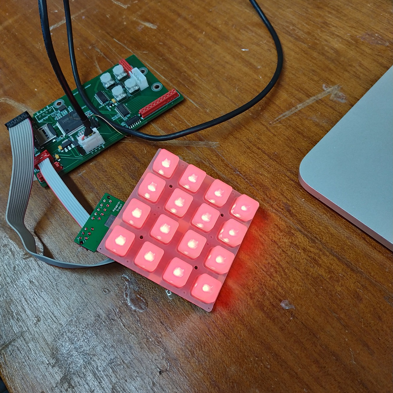

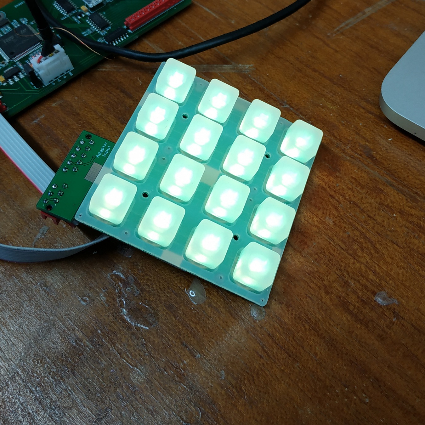

Done! Works great. :slight_smile:

See it in action here:
https://www.dropbox.com/s/c9c0jklz28nhe2r/VID_20200407_105633.mp4?dl=0

And another video:
https://www.dropbox.com/s/3tlwui62v8ot5ls/VID_20200407_171420.mp4?dl=0
