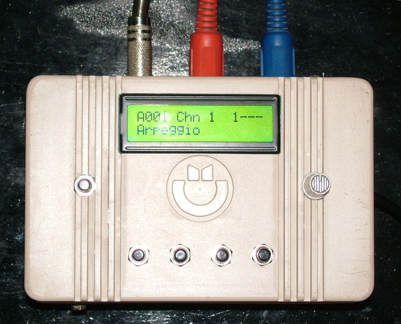

Hi I all:
Recently I finished a MIDIbox SID for a friend (Bruno). I want to share some
pics because the enclosure is a C64 power supply.
Hi I all:
nice one.. lucky friend.. that looks tidy mate!
..im guessing it’s a single?
You did that?! I was in shock after opening PSU and had problem with simple cable change! You’re crazy if you taken out all resin (or whatever that hard, big, milk-coloured block inside is)! Outside looks great. Any photos of boards?
Yes, it’s a single SID one.
The PSU didn’t have any resin or strange stuff inside, but it was obviously
repaired, so maybe someone did the cleaning before me.
I don’t have any pictures of the inside (I think), and since I don’t have it
anymore, I can’t take any now. May be some day I go to Bruno’s house
and open it, but I don’t think he let me do that ![]()
Thanks for the comments.
I went and opened up mine out of curiosity and was like,“WTF is this stuff?!”
Nice work.
I wish my friends would make me cool synths… actually, that would take the fun out. For me, at least half the fun is in the building. ![]()
may i ask you how you have cut the LCD hole? it seems so perfect like a lasercut ![]()
Hi:
No lasercut at all. I drawed a rectangle where the LCD will fit, then drilled holes
close to the line, leaving minimum space between them. I used a cutting plier to
cut between holes and take away the rectangle, then a file to smooth out the
border.
Very low tech ![]()
