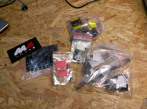

Here we go !
18h20, the iron is warming. 20h00, it’s cooling down.
Thanks to Modular Addict and TK (and this page: http://www.ucapps.de/mbhp_core_stm32f4.html ) I have to say it: it’s SUPER easy to make !
Next, i will make the DIO_MATRIX and MIDI_IO boards.
TK. … You make a really good job, you’re cool enough to share it with us… So thanks again !
