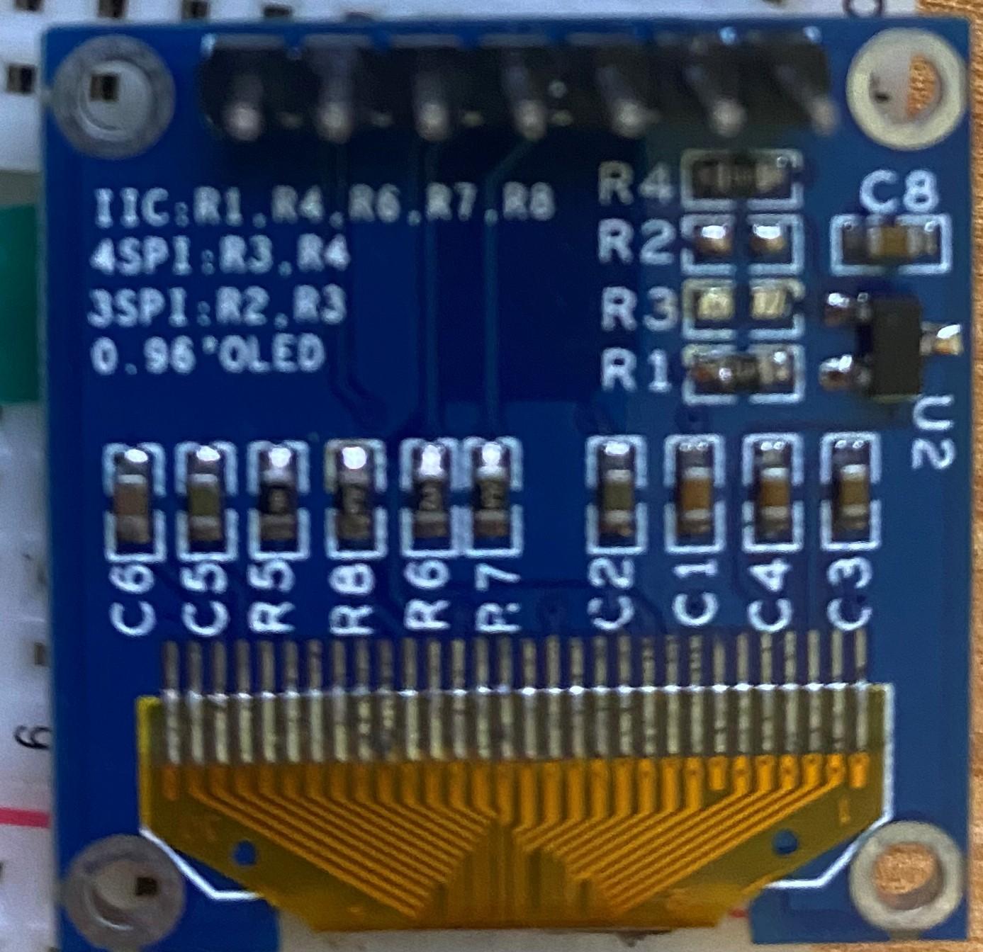

Finally got the dust off of my STM32F4 board to work on a project I started 3 years ago. Sad news, I cannot get these OLED displays working. They’re factory wired for 4SPI, which I tried initially and no dice. Realized they might need to be I2C (IIC), so I moved/added the SMD resistors for that, but still no dice. Blank.

  • You want 4SPI configuration, not IIC like I have in the pic.

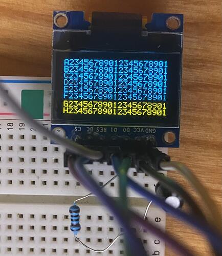

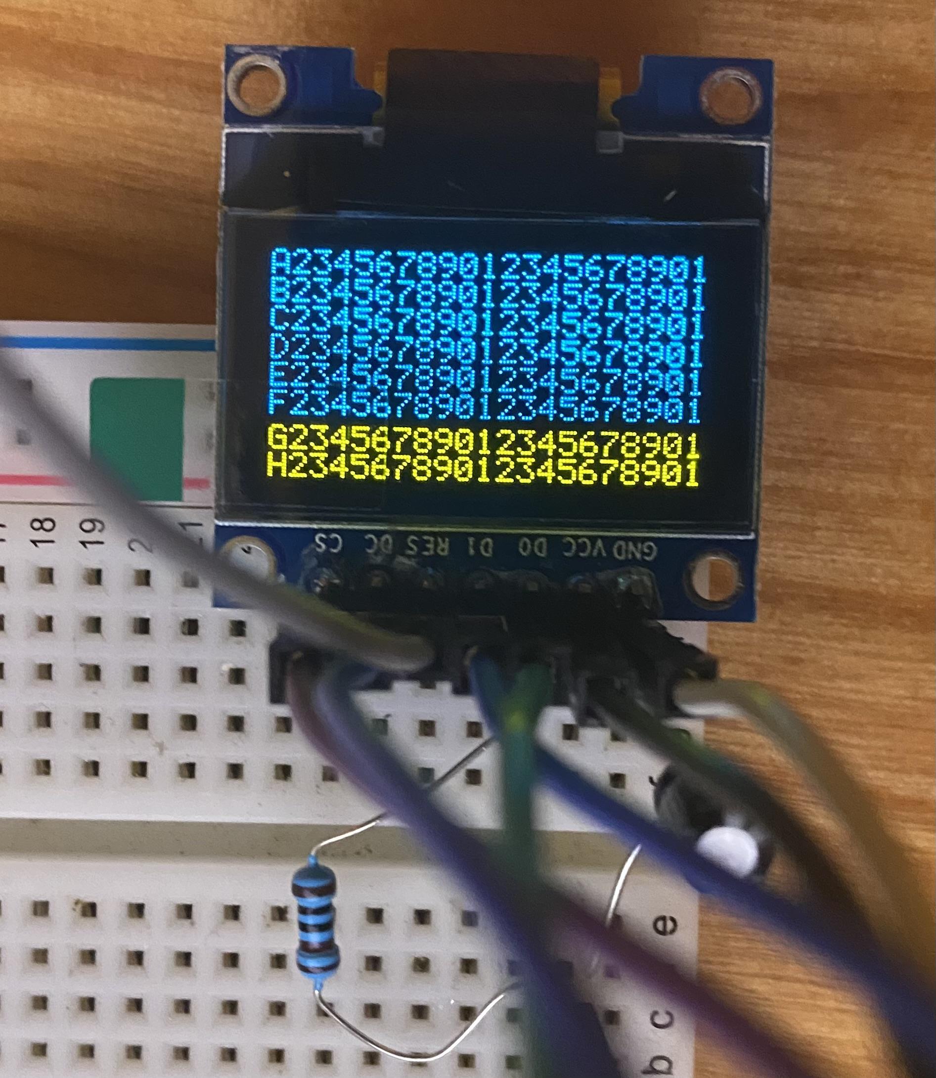

Now for some test display data. Lets set some values for your SSD1306 OLED’s in MIOS Studio :
  • Click on Tools -> MIOS32 File Browser
  • Click Create File
  • Create some name like  LCD.NGC
  • Click Update
  • Click on the file you just created
  • Click Edit Text and add the following test example:
RESET_HW
LCD “%C”
LCD “@(1:1:1)A23456789012345678901234567890”
LCD “@(1:1:2)B23456789012345678901234567890”
LCD “@(1:1:3)C23456789012345678901234567890”
LCD “@(1:1:4)D23456789012345678901234567890”
LCD “@(1:1:5)E23456789012345678901234567890”
LCD “@(1:1:6)F23456789012345678901234567890”
LCD “@(1:1:7)G23456789012345678901234567890”
LCD “@(1:1:8)H23456789012345678901234567890”
  • Click Save
You should now have 8 rows and 21 columns of text. If you need to flip it 180 degrees, you can redo the steps above and add set lcd_type GLCD_SSD1306_ROTATED  before you store.

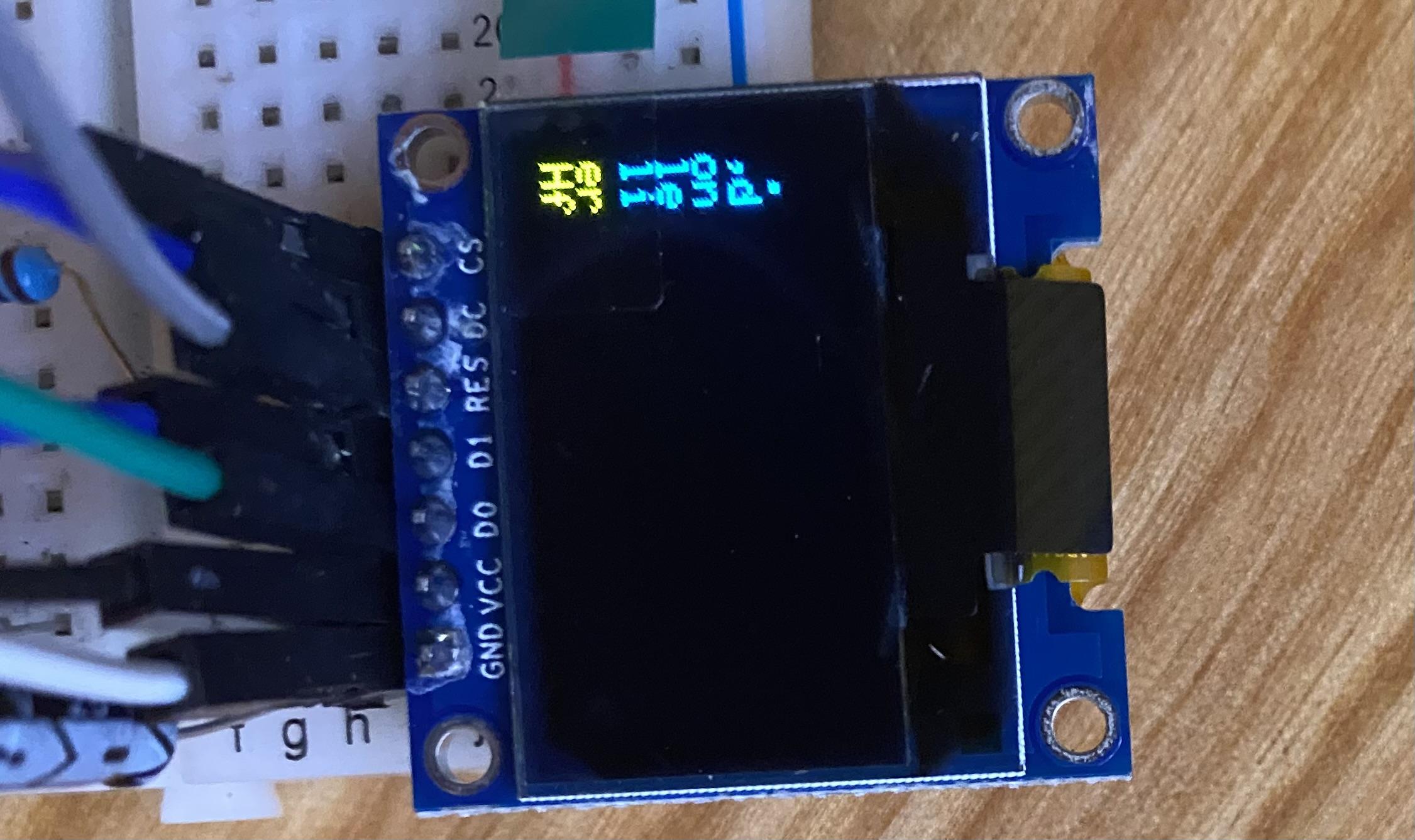

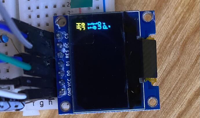

The only other question I have is can I rotate this 90 degrees instead of just 180? My current thought as a workaround is to create a font set that’s rotated 90 degrees and write out lines a single letter at a time:
LCD “@(1:1:3),”
LCD “@(1:1:4)o”
LCD “@(1:1:5)l”
LCD “@(1:1:6)l”
LCD “@(1:1:7)e”
LCD “@(1:1:8)H”
LCD “@(1:2:2).”
LCD “@(1:2:3)d”
LCD “@(1:2:4)n”
LCD “@(1:2:5)e”
LCD “@(1:2:6)i”
LCD “@(1:2:7)r”
LCD “@(1:2:8)f”
It’d look like this, but you have to imagine all the letters are rotated counter clockwise by 90 degrees:
