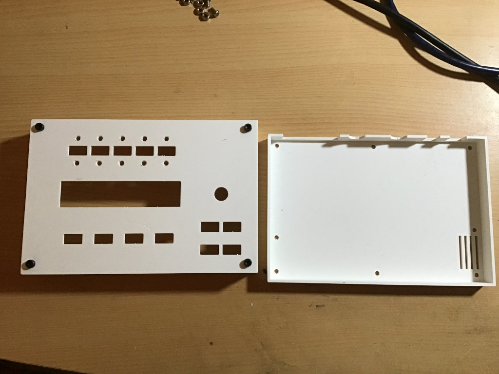

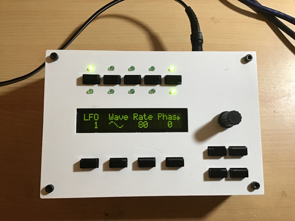

I bought a sammichFM kit without the case (the reason was I did not like how the laser cut box was looking). I installed my machine in a Teko box, making it even uglier The poor machine was forgotten a few years in a cupboard, and thanks to the lockdown in France, I found it a few weeks ago, covered in dust.
As the original case made by Wilba has disappeared from the Web a long, long time ago, I decided to make a 3D printed case for the machine. As you can see, result is not bad (and much better than this awful Teko enclosure)…
The files have been created with FreeCAD, I put the STL files here if someone wants to use them.
I found some possible enhancements (like having holes to reach the trimmer for contrast and backlight level), but I did not want to print the box a second time (more than 7 hours to print both parts).
The source file in FreeCAD format are available, just ask me if you want them.
[SammichFM Bot.stl](< base_url >/applications/core/interface/file/attachment.php?id=15413)[SammichFM Top.stl](< base_url >/applications/core/interface/file/attachment.php?id=15414)
