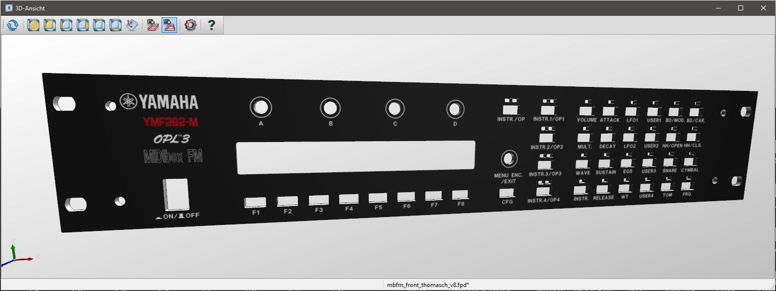

The goal is a 19" case with the extended user interface.
The matrix row/column buttons of the original expansion design will be extended to a dedicated button for every single function.
To make this work without having to change the code, i want to use DPDT tactile switches, which are really a rare breed out there.

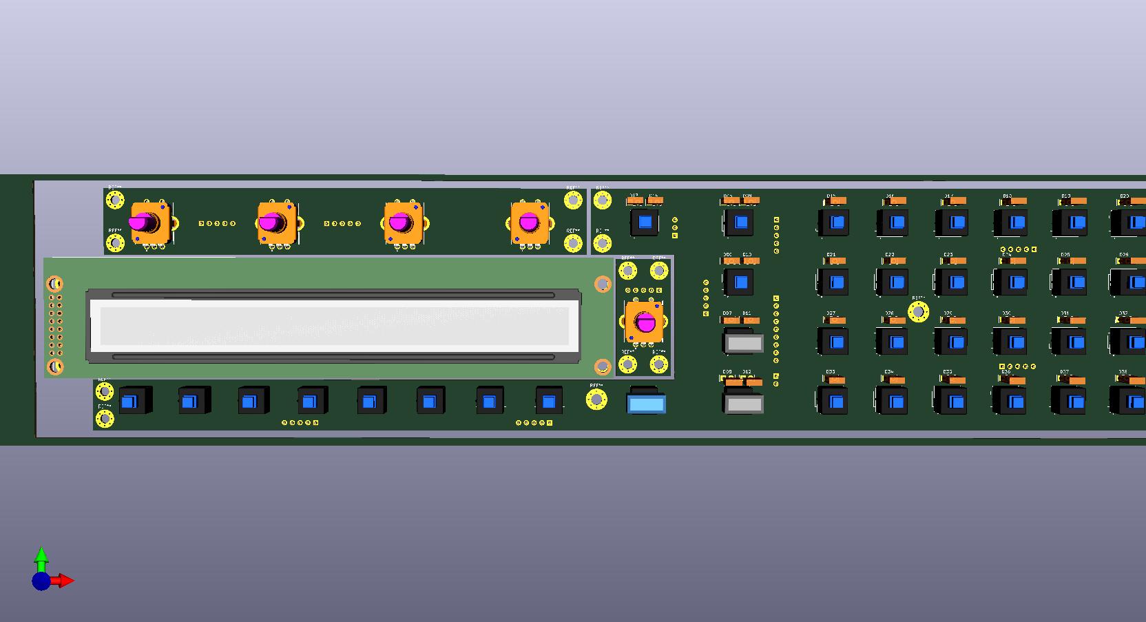

Here are the first results of what i’ve learned until now:
I want to use rectangular 2mm x 5mm LEDs, because they look so much cooler than the regular round ones.
But i realized quickly, that traditional CNC milling will always make rounded edges on the cutouts in the panel, with the size of the diameter of the milling tool.
This will make it hard to fit a rectangular LED into the cutout without adding additional gap width to the cutout or sanding the edges of the LED.
I will have to checkout if laser cutting, punching or something else might be the solution for my problem.
Any hints from the more experienced case builders are highly welcomed.

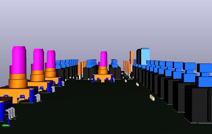

The DPDT momentary switches i will use, are much taller than most tactile switches and i realised, that there might be a problem with the height, because the rotary encoders are too short to have switches and encoders on one board.
It seems i have to make 2 small extra pcbs for the encoders and put them on shorter spacers, to get them closer to the prontplate.
This sucks a little bit, because it will need more space for additional screws and some additional pinheaders.
When you design a ‘control surface’ PCB, first thing to think about is the different height of the components, pots, encoders, button+caps and screen. By changing the part (e.g. EC12) and/or reference within the part(e.g. EC12E1220407) you can try to make them match
This must be considered first with stand-off length, panel thickness etc… now you know. :wink:

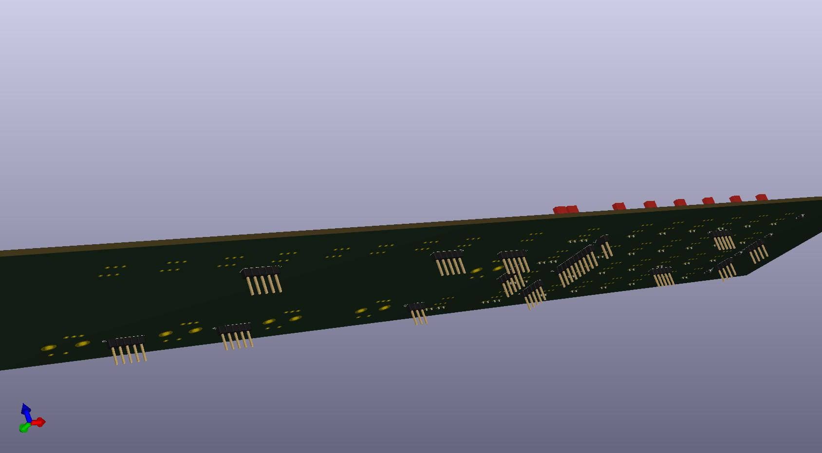

Yeah, in case i would do that, i would only use SO-16 packages, the DIL-16 used on the DINX4/DOUTX4 are way to big.
Using smd resistors would be mandatory too, to be able to fit that to the board.

I tried to create something with the SRs directly on the board - there is really little space between all the switches. :smiley:

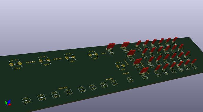

I made a new schematic utilizing a 4x6 diode button matrix, that might be more efficient than the standard wiring.
MBFM_Frontpanel_PCB v.05.pdf
It uses 4x 74HC165 SRs (DIN) and 3x 74HC595 SRs (DOUT). I will use SO-16 Packages.
For the resistors i’m not sure which package might fit best, maybe a resistor array might be the best choice, for the ease of soldering.
Atm i’m just sourcing which package type for the array might take the least space, while still being solderable by hand. Any advices?
