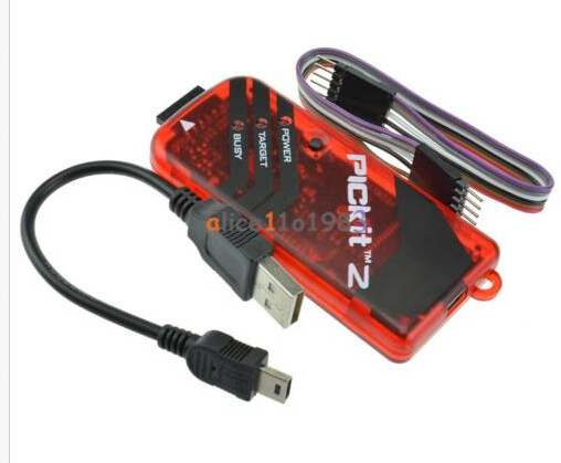

It would be helpful to list the actual PICkit clone first (+ pictures). I use the DIAMEX one recommended here with flying connections (no external voltage) and simply buss powered from my computer. I also went for auto-detect Vdd level (choosing the correct family will ensure this).
Hi Yogi and Latigid on, Thanks for the heads up.
This is the picket2 clone i have, its a cheap one.
http://www.ebay.com/itm/Pickit2-Pickit-2-PIC-Microchip-Development-Programmer-Seat-MP-Lab-Debugger-Tool-/121755779431
The programmer is fried so not word to show it here :slight_smile:

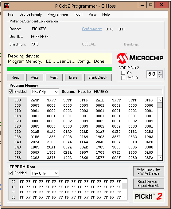

Whoohoo This noob is so happy, I managed to flash the pics with a pickit 2 clone from ebay (see the picture below).
Once I connected the module to j4a 4 lights flashed and in mios is can see the IIC module is detected!!!
It is much easier than I thought. Just connect the pic directly to the programmer, no external voltage. (thanks latigid on and Yogi!)
  1. Connect the Pickit 2 clone to the chip
    icsp header        16F88 pin
1 vpp                  4
2 vdd                  14
3 GND/vss          5
4 PGD/DAT         13
5 PGC/CLK         12
6 Aux / NC
  1. In the Pickit2 software: Select [Device Family], [Midrange], [Standard]
  2. Your device should be detected. ( If not its either broken or the conenctions are wrong )
  3. Open the hex file and select [Write] after that [Verify]
  4. Just to be sure I restarted the Pickit2 software and  selected [Read] again.
If all went well and you used (mbhp_iic_midi_v1_0c.zip) you should see the same as on the screenshot.
In the process I managed to destroy one programmer and 2 pics. ( by trying to apply 13.5v on the pic )
3 other pics that had dataprotect enabled I could easily recover by selecting [VDD 5v] and erase the chip.
Thanks everyone for your help.
