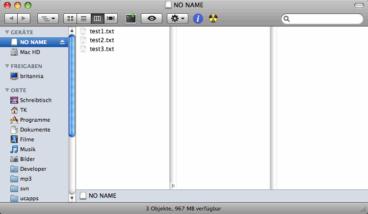

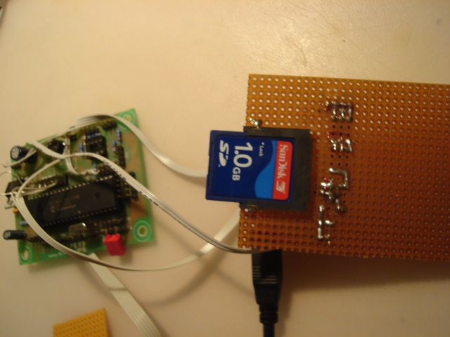

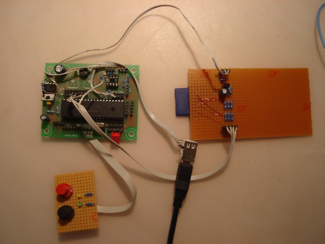

Surprise :wink:
I quickly soldered a prototype board, and uploaded the example application for a “mass storage device” (AN1003).
The C code which accesses the SD card looks simple. However, the challenge will be to make the code small enough, so that it fits into existing applications (w/o USB support of course). It also makes sense to use the bitbanging method instead of SPI peripheral for higher GPIO flexibility (speed doesn’t really matter, considered that a SD card is already much faster than a IIC EEPROM)
I think, that it can be easily re-written in assembly, and provided as a MIOS Module
Best Regards, Thorsten.
