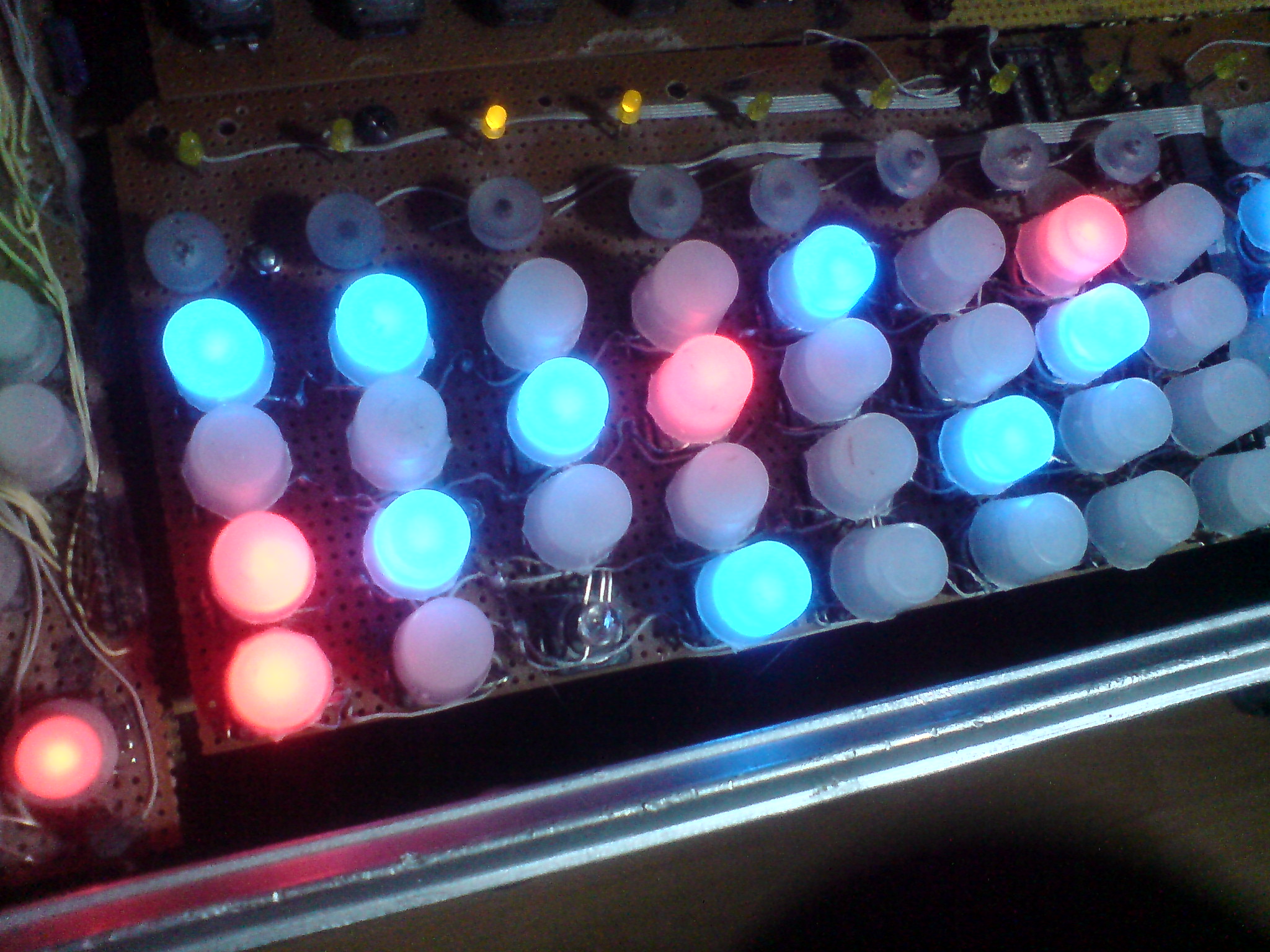

but i like to show how i made them.
This are “Ink Cups” from tattoo machines.
They are very cheap (100pcs about 2-3$) and available in different sizes.
I filled them about 4 mm with hot clue.
The LEDs are bended above tacticle buttons like this way.
Now use a soldering iron with an old soldering tip
to head up the center part a little bit (about 1mm deep) and put the cup on the LED.
Done!

+1 for the creativity :flowers:
Danke nILS!
Not macht halt erfinderisch :wink:
Love it.
Yes this is definetly a very cool idea! I will try it myself sometime!
