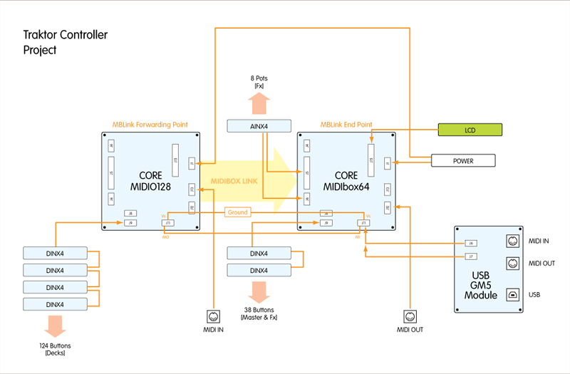

The project i’m thinking of is a traktor controller for 4 decks.
It should have about 133 buttons 8 pots (for fx) some encoders.
No faders as i’ll be using 4 audio separate output and do the mixing on the mixer.
The MIDIBox 64 should control the Master part (Master tempo, browser, view selection, Effects) with buttons (less than 64) encoders and pots.
The MIDIO 128 should control the four decks, using mostly buttons and some encoders (that if i’m not wrong are connected do the DIN).
So, as u see, the idea is to have the two main modules one controlling the master part and the other controlling the 4 decks.
I need to have the MIDIO 128 to have the possibility to control more buttons.
I didn’t consider using 3 MIDIBox64, but that would be a solution, but honestly don’t know what’s better.
This is the starting point for me, also because this is important for understainding which parts i need, and ordering them.
Also i have other questions but will keep them for later.
As i have understood how the main cores have to work i’ll start working at a prototype (just for one deck + master section) and try to fix all probelms and doubts.
I attach an image of the schema of the project.

Reading about your concept, I do think that perhaps a customized application would be most suitable for your needs. Of course that takes some programming skills, but seeing as your friend knows C and may be able to help you there, and seeing as alternately you would probably need to learn a little bit of PIC ASM (which is a more difficult language than C) to modify the MB64 and MIDI apps, it might be a good opportunity for you to learn how to program in C… that is compounded by the fact that there are very good DJ controller apps in place already which use C…

I will post it in Design Concept, i think it’s beter to go on there.
