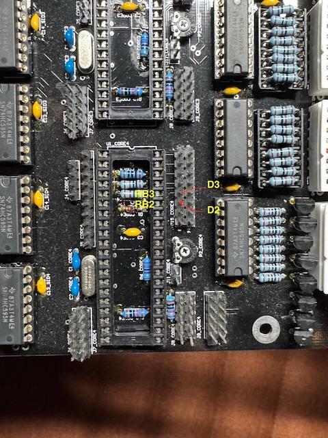

Would you mind confirming if my picture is correct concerning the locations of RB3, RB2, D3, D2?  The diagram you provided looks like all D3’s on the J15 headers would be tied together, but I’m not experiencing that, and I’m thinking either something different is happening on this board or I have the wrong locations.
EDIT:  Also wanted to add, in case it helps, that I am running the Newhaven OLED.  On Core1 I soldered the little jumpers on the bottom side of the board under the core, but did not solder them in the other cores, would that be necessary? The OLED works fine when connected to core1, I think at some point I installed the custom LCD driver I found on the Newhaven OLED post on Core1 PIC.  When I connect the display cable to any other J15 header I see nothing, so I guess they are missing the custom driver, and would need the tiny solder pads jumped, although that’s not probably not needed to get the CAN bus error resolved.
Yes, I can confirm that RB2/3 are marked correctly. You can ignore D3/D2, because in distance to MBHP_CORE the RB2/3 pins are not connected to these datelines, but to different IO pins at J5 (that’s also the reason why a special LCD driver is required when displays should run in 8bit mode)
On this picture I can see that the diode is connected the right direction, so this is not the problem.
