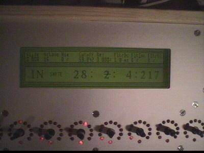

However, on the other hand I’m very satisfied with the new possibilites and don’t think that more encoders are really required. Here an example:
This is the common view. Panorama is controlled by the encoders, volume by the motorfaders.
Now I push the “Assignment: Track button” and get a assign menu
I push the V-Pot #8 button to enter the setup values which are now under control of the encoders.

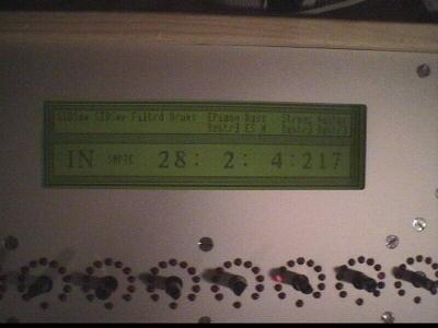

Another example: I push the “Assignment: Instruments” button and get an oversight over my VSTi’s
I push V-Pot button #6 and can control the VSTi parameters with the encoders…
The handling is very fast - just two clicks to select a bank of parameters
And with the “Bank +/-” button I’m able to scroll through the track-groups (8 entries per group)
Note: the screen output is send by the host application and therefore is not under my control. I only interpret the incoming data streams and print them out…
