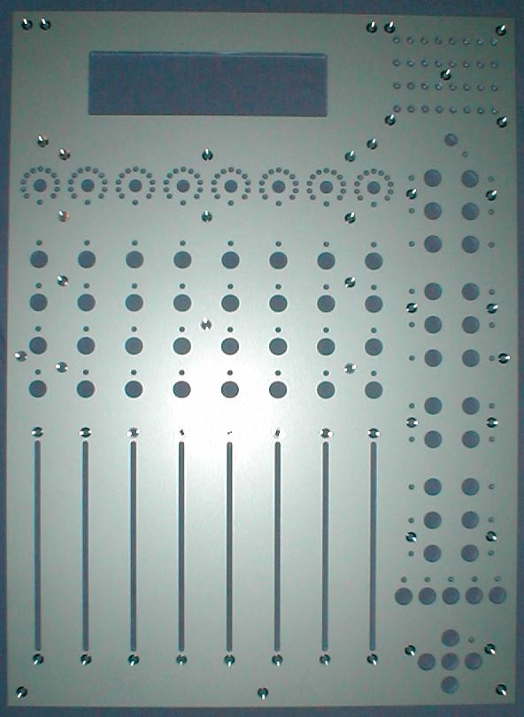

Thorsten thats a  fine panel
one silly question the 12X4 led holes at the right upper side where are those usefull to?
keep them comming…  :)
These are 32 additional buttons for LC functions, MIDI remote commands and/or SFB events (Display mode switching, etc.)

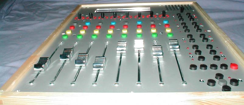

Here an update of the current status — every part fits fine, but the modules have not been connected yet… next update on sunday :slight_smile:

Wow Thorsten!  :o I could sit and look for hours! ;D
