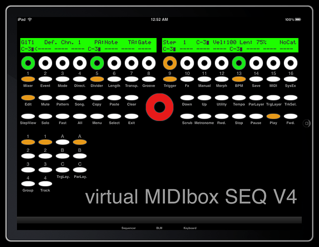

Virtual MIDIbox SEQ V4 for iPad
Here a first impression of the virtual MIDIbox SEQ V4 for the iPad.
As you can see, there is some space for additional buttons or display functions. :slight_smile:
Due to the delayed delivery in Europe I won’t be able to test and finish the emulation before june…
Currently I cannot estimate if the timings will be so stable like on a real MBSEQ, however together with the upcoming OSC option we will get at least a nice remote control :slight_smile:
Best Regards, Thorsten.

I already feared that the GP knobs are too small, but I will try to improve the touch handling with tap and stretch gestures.
As a workaround, you can already use the big datawheel to change the last selected value.

The response seems fine, but my fingers are big and those buttons are small. 40x40 seems to be the UI standard to iPhone and iPad. Seems like there is lots of space for UI options here. It would be fine if the LCD encoders were buttons and the main knob was all you turned.

Ok, so far! I saw the Youtube Video an i think the Knobs Solution won´t work for (Wurstfinger) wide-fingers.
It´s a Touch Panel… why not touch direct into the MBSeq Display. A tap on a note in the Display poups a dialog to choose the right note. A dropdown dialog!
This creates more Space for other important Buttons!
Only a suggestion!

Yes, different page views for more comfortable parameter entry makes sense and they are easy to realize.
I guess that at the end the “HW frontpanel” view will only exist for historical reasons :wink:
