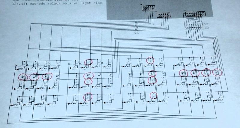

I attached a picture of the top panel schematic with the nonworking LEDs circled in red.
Buttons all seem to work.  Diode and LED orientation is correct.  There is continuity between the non-working LEDs and their connecting points on P6 and P7 headers.
Not sure about connectivity to the transistors yet…  Still trying to figure out the traces there.
Anyway, if anyone has any hints about where I should be looking, that would be greatly appreciated.
Hm…  I just unplugged everything and plugged it back in…  The vertical columns of non-working leds moved, so I’m guessing the vertical columns are a problem with one of the 10 pin cables.  Second horizontal row LEDs don’t work no matter which way I orient the 16 pin cable though.
edit: Two of the 10 pin cables had problems…  I’ll fix those, and I bet the vertical columns of LEDs will work.  But the 16 pin cable (P3 to J15A) is fine - from the schematic, it looks like the horizontal row issue wouldn’t be related to the 10 pin cables.  Possible that I’ve got a bad transistor maybe?
