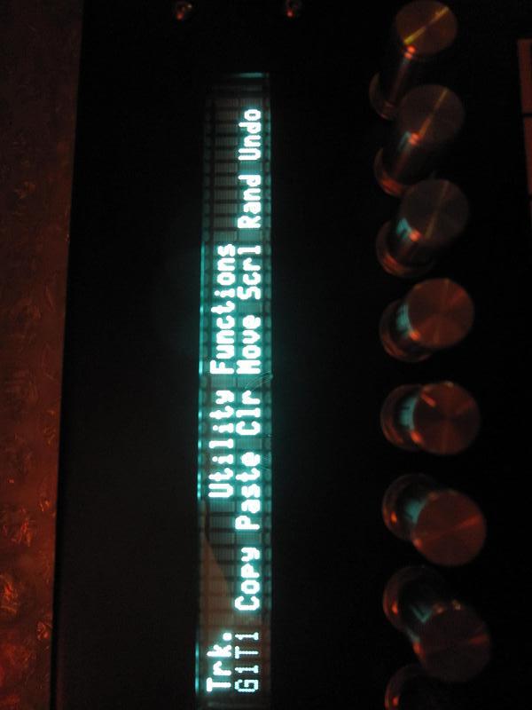

I started assembled my Core32 and pulled my finger out and wired up some of the NOS VFD’s I bought ages ago.
THEY LOOK LIKE SEX.
I’ll be using them in a SEQV4, and getting a panel laser cut up..

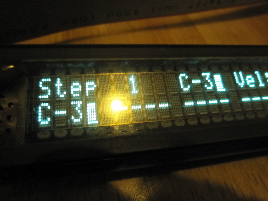

Here’s a pic of the VFD’s up close.. although it’s hard on my crappy camera to convey how cool these screens look.. Straight out of 1986.
Regards
Mike
Indeed, they look really nice!
really really nice

Yep.. pics will come soon.
As for power.. I took the 5v regulator off the board and connected it to a massive (10cm x 4cm x 4cm) heat sink.
I was pleasently surprised how cool it runs now.. even after a few hours on, the heatsink feels only slightly warm.
I work as a AV tech, so gels are easy to come by. They are basically thick heat resistant coloured plastic in many colours. but to be honest, the green glow of these vfd’s fit nicely with the green buttons i used and the green backlighting on the laser cut text.
Cheers
Here’s a few little pics.. no case yet, gonna build something nice out of timber.
