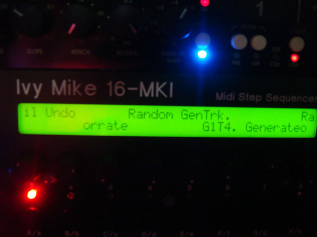

I managed to find that it happens from the random page quite a bit after hitting generate, it clears back to normal when you navigate away from the screen. Only the left lcd is effected. I took a screen grab (haha!) with my camera, will upload tonight.

Heres a look at this bug.
(updated the image size now, sorry!)

I can’t read the display - it’s too small in the small version and too large to fit on my screen when expanded (plus, I hate scrolling sideways because that means I need to adjust the vertical scrollbar up and down, back and forth). Couldn’t you just downsize that picture to something like 600x480 pixels? Also saves bandwidth…  ::slight_smile:
Best regards, ilmenator
I used the quickzoom addon to get around that but yeh it could be smaller :slight_smile: (damn you and your nice camera!)
That’s a bit strange mate, it doesn’t look like software cause it’s really random, like, it clears some parts of the line and not others. Don’t suppose you’ve tried switching screens?
