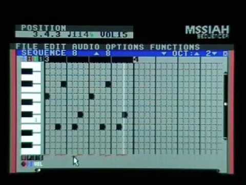

This MSSIAH video is also very similar to what I mean.
Its got 6 channels (using 2xSids) and each channel is using a different instrument.
