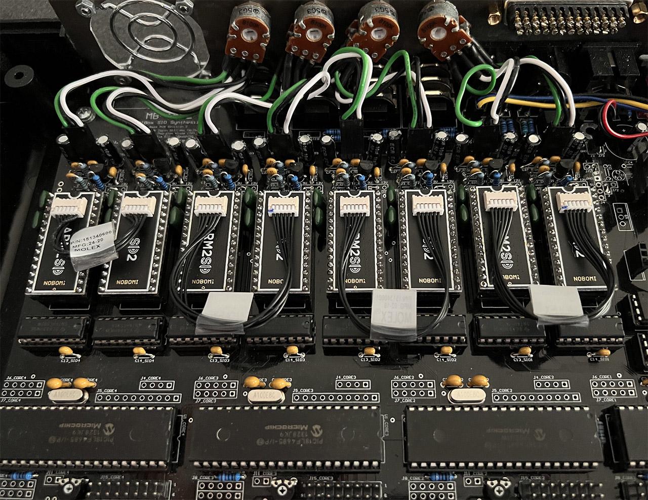

Many, many years ago I built an MB-6582 with 8 real 6582A chips in it. I use an original C64C powersupply.
I love my MB-6582 but it’s a bit to noisy for my taste. So I’m considering buying 4 ARM2SID’s to replace my 8 real sids. I think that would make it a lot quiter.

Late to respond but thought I would offer my $0.02 based on my 6582 experience. I was using a custom PSU with it, both for real SIDs and a pair of ARMSIDs. The problem I was having was a bit of 5V droop due to the cable length and my power connector was a bit sketch. So  I’ve since converted it over to the switching 7805 regulator method which seems to be working for both ARMSIDs and real ones. One thing I really like about real SIDs is they can offer a sort of chorus in stereo mode due to differences in each chip. I don’t get that with ARMSIDs. On the MB6582 I plan to always run both. I believe you are correct, though, that the ARMSIDs only need 5V though there isn’t much harm in keeping your 9/12 rails if you want to populate real SIDs at a later date. The switching PSU method does require changing things around a bit. It can be reverted but not easily, although it can be made to work with 6581 or 8580/6582 SIDs (and ARMSID) which might be worth a look if you’re not already running this option.
I do find being able to choose between them is really nice. The real SIDs, sure they’re noisy, but the filter sounds better and you can mitigate the noise with a gate. When I’m doing a lot of filter stuff or just want that chorus/phasey kinda sound, I’ll reach for them. Otherwise the ARMSIDs are less fickle.
I do wish we’d see an update to the MBSID firmware to support some of the enhanced ARMSID options but I’ve been quite happy with them and plan on picking up more (once retrocomp.cz is able to ship to the US again). I recently busted out my sammichSID again while the band is considering live shows so my current ARMSIDs are stuffed in that guy.
