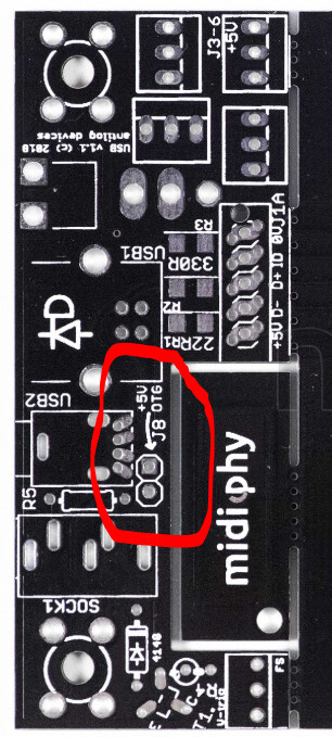

First thing: did you connect the jumper on the USB PCB?
I think the political response would be: “I have no recollection of doing so…”
I that just stopping me from getting +5v through to OTG, or breaking the USB chain entirely?
It just interrupts the +5V supply on the USB A socket. I don’t know the workings of a Keystep: can you power it externally?
Right - that probably explains the power issue, but I’m powering the Keystep via external supply anyway - so that’s not my connectivity issue… it works fine under the 5 pin Midi IN 1 scenario (with external power).
