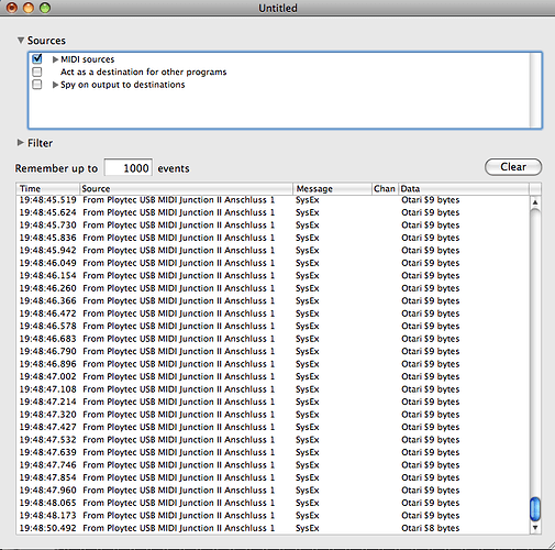

In order to exclude a MIOS Studio or Java installation issue: could you please doublecheck the incoming MIDI Messages with an alternative MIDI Monitor like this one: http://www.snoize.com/MIDIMonitor/
You should receive 9 byte SysEx messages like shown in the attached snapshot.
Best Regards, Thorsten.

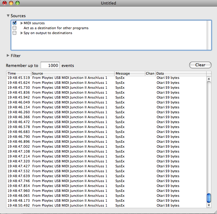

Thanks for that! Unfortunately (or maybe for the best) I get 2bytes :frowning:
*See attached image*
Ok, this seems to be a firmware bug (maybe a protocol violation), because from my experiences with various interfaces (and especially with the MBHP_CORE_STM32 module) the internal MacOS driver works pretty stable (IMHO the most robust implementation compared to Windows and Linux solutions I know)
I added the interface to the blacklist.
