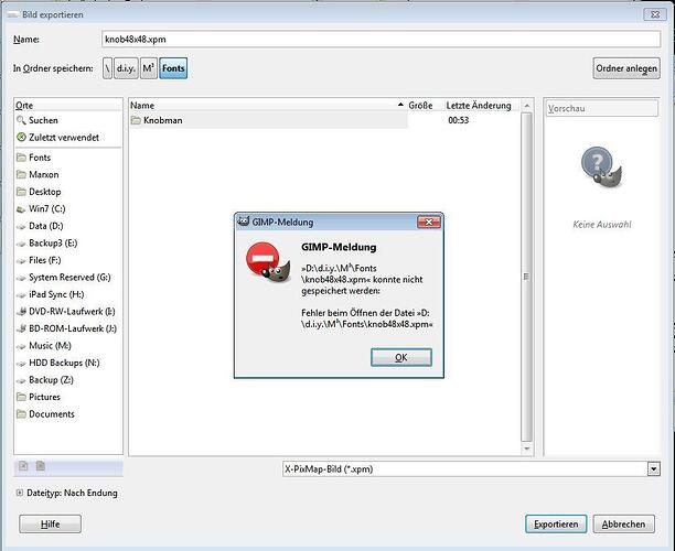

Hi John
Great usefull tutorial!
I immediately started to create some bigger knobs.
Unfortunately GIMP shows this error when exporting the .bmp as a .xpm file
I also tried “XPMEdit” and “AutoImager” to convert the bitmap.
But converting these .xmp files leads to useless .inc files.
Do you know what could be the reason?
Or would you convert my .bmp files for me, please?
https://drive.google.com/file/d/0B-plp4B8LLvaUnlTaXJiTXhuWnM/edit?usp=sharing
Best regards
Marxon
…heres one more tip from me: instead of using hundreds of programs for thousands of uses, stick with one program that is more versatile! eg. for creating icons/fonts use a spreadsheet. attached is an example of how i create fonts in excel. no converting issues, no looking for converters, etc…its really great for all sorts of code-related stuff, in fact any spreadsheet will do the job…:wink:
Hi Marxon,
I just converted your *.bmp to *.xpm with Gimp Portable 2.8.10 (see attachement). No problems here…
Unfortunately I can´t tell what the problem might be on your end. I´ve not seen this error before. If I had to take a guess I would say maybe there is an issue with the file path (dots, exponents). I´ve encountered errors with paths like this before. Not necessarily with Gimp, but with other Apps.
Other than that I´m afraid I can´t be of much help.
Your *.bmp looks fine, the *.xpm I created seems to be in order and ready for further processing.
Till you get around this problem I´m happy to convert your *.bmps. Just pm me.
