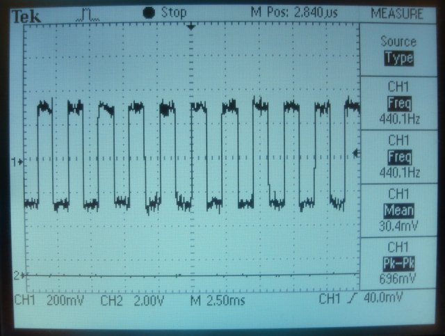

Thanks for the little shock in the evening - I’m wide awaken again ![]()
Yes, note A outputs 440 Hz (the scope jitters between 439.5 and 440.5, but this is a common measuring problem, don’t panic!)

Phew! Thanks Thorsten - that’s great news.
0artin
