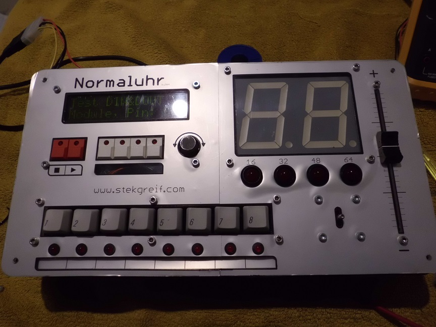

If I start the unit the LCD display shows Mios V1.9  Copyright 2007 by T. Klose and after this hangs up with:
Test DIN&DOUT Module Pin: D0 (like seen in the fotos) and stays there forever.
Any help from where to search for errors would be very apreciated especially what the message means …

Have you asked the seller about it? Was it sold as working or as-is/for parts? You should connect it to MIOS Studio via MIDI to see if you can communicate with the Core, thereafter you can try to upload the correct application.
http://www.ucapps.de/mios_download.html is where you’ll find the firmware.
Latigid is right , it’s the test application loaded not the clockbox application!
after that:
There an empty socket for the big LED segment … IC is missing … i think without this IC the big LED won’t work.
there certainly a problem here … that’s why test app had been loaded.
what is the identity of regulator and the IC next the missing IC for the LED segment?

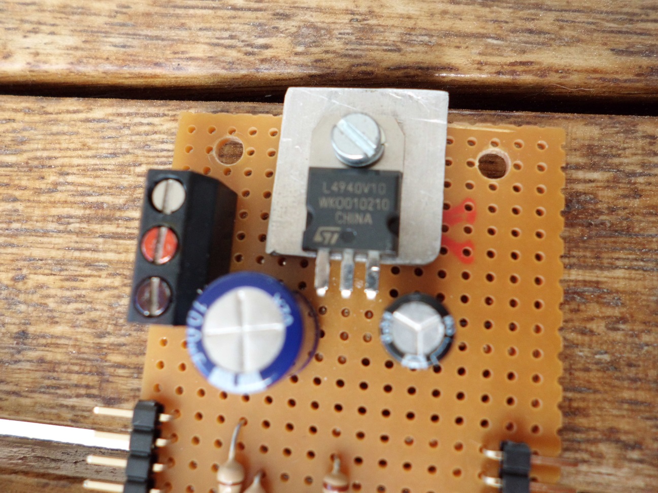

I took some more pics from the display board from the big LED display with the missing IC.
Regulator is L4940V10 (low drop 10V regulator) and works (input voltage is 12,3 V and output is 9.93 V - so I think thats correct)
But I think the unit should work without this IC or the whole board ?? Or I’am I mistaken and the Core senses
that the LED display is missing and so the rest will not work ?
regards
Nick
Sorry, I see that you wrote “as-is” in the OP.
For the IC, it’s probably the same LED driver for the second 7-segment. I guess the decimal point is not wired. The main functions should work fine without this connected.
