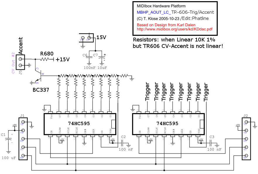

draft for a 606 accent CV - and 8xTrigger
tr606 accent trigger
a bc337 and a 680Ohm resistor do the job…

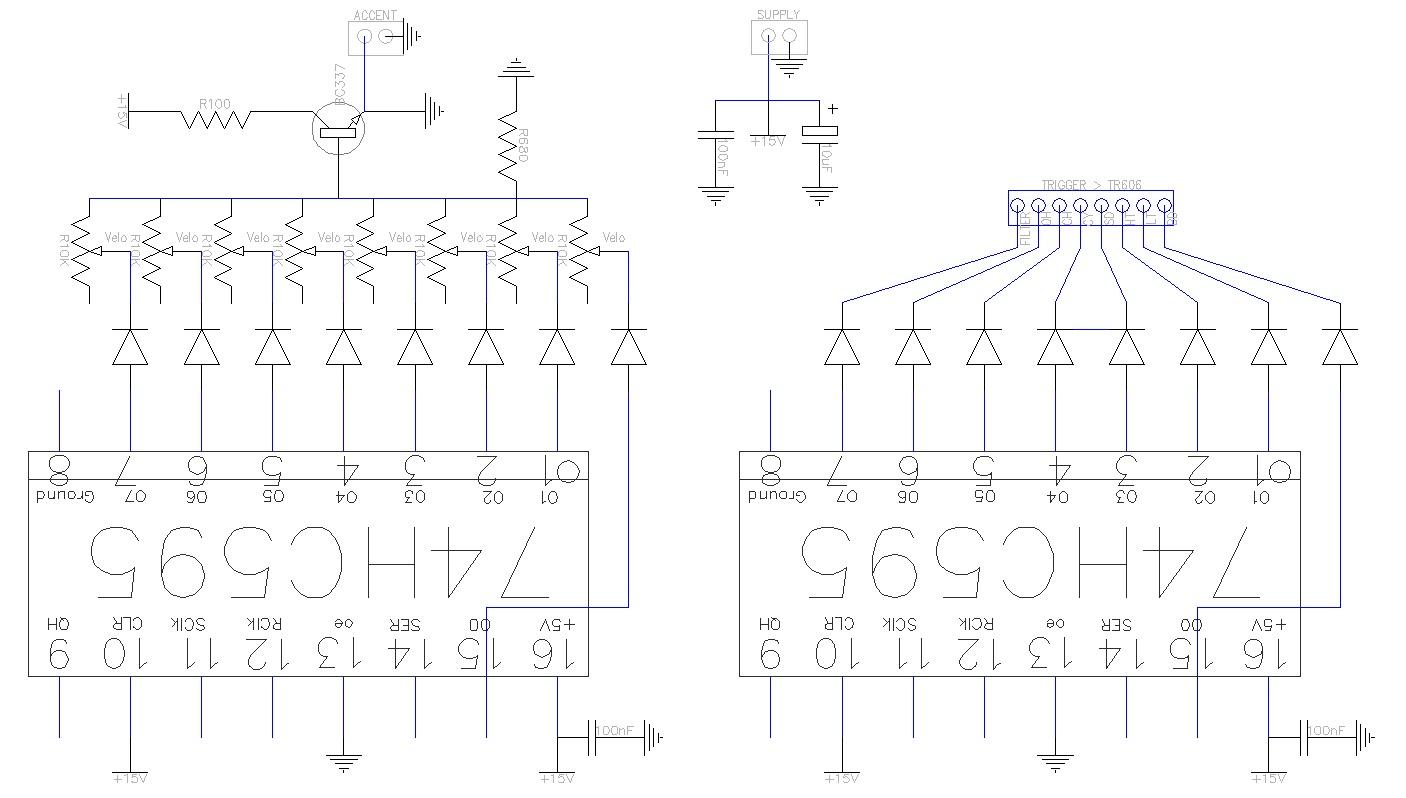

tr606 accent trigger real
TR606 ACCENT
it is nessesery to “tune” the accent stages…

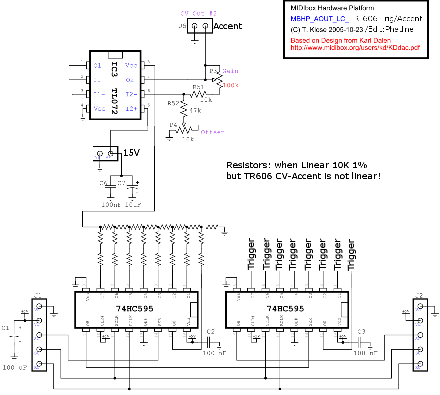

TR606 Accent final
…after some testing i use this circuit
