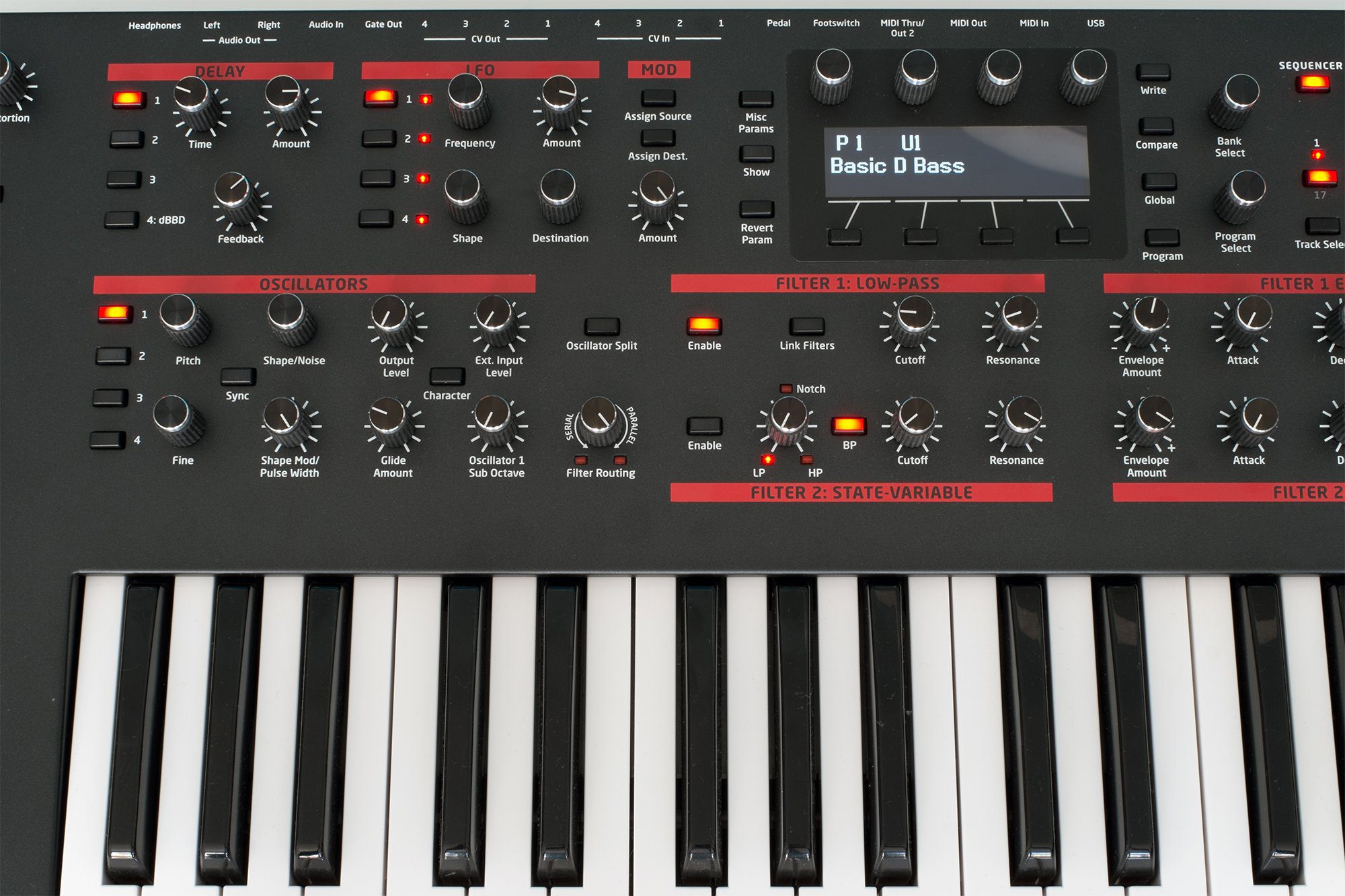

So i can have LFO Section consisting two pots and nearby two buttons (or one toggle button) labeled “1” and “2”  (or “1/2”) to switch the group of pots between LFO1 and LFO2? The idea is to virtually double the pots.
Take a look at the Dave Smith Pro 2 and its columns of buttons (radio buttons?) 1-4 for delay, lfo and osc sections
