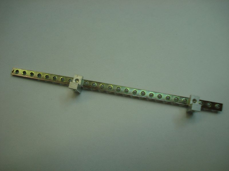

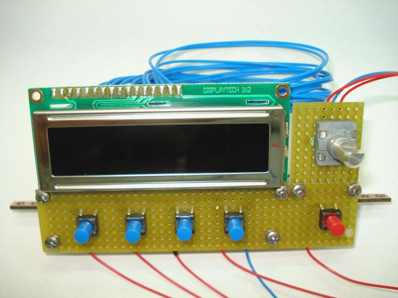

Some guys asked to me how I mounted LCD without using screws on panel.
So , for those who interest , I post these pictures that explain how with
a drilled bar an two 90° squares you can mount your surface using no screws on panel.
The bar will be screwed on chassis box.

Nice fiddly bits,this is the kind of stuff I like to get my head around although lately I have been giving the old glue gun some heavy use…lazy I know.
Looks like a good solid way of mounting the lcd btw,good tip.
