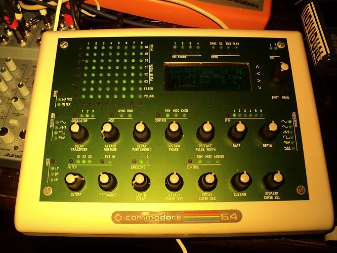

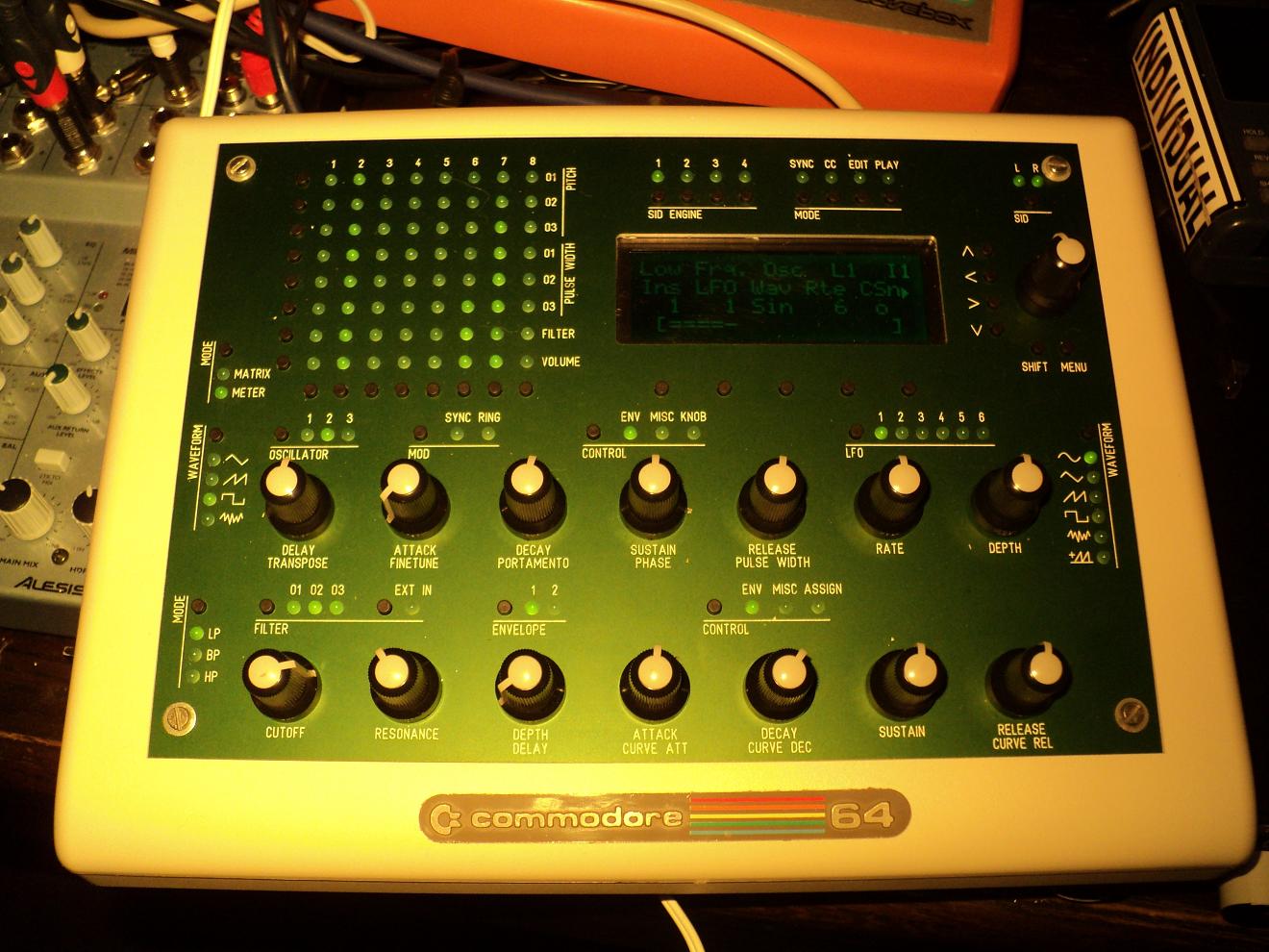

Hi everyone,
Here some photos of my new toy.
I want to thank u all for for sharing information.
Tk,Tim and Wilba thanks for the pro work!!
I geuss im getting addicted to midibox :yes:
Peace!
Hans
Hi everyone,
Peace!
Hans
The panels are from Julianf (recommended)
Sids from c64 doners:)
Used the 5v6 zener/triac crowbar to avoid horror.
lovely lcd from poland(ebay)
Next to do is taking the fan out off the 5v line,
add an 7805 for it on the extra perfboard and feeding it with dc from before the rectifier.
trying to figure out the options for the external connector (ssm2044 or something like that)
and add different knobs because these ones are not mine:)
and ofcourse make some music with it!!
Dear Hans,
I think your LED’s are a bit bright, and too yelowish!
Dear Hans,
Tbh, it may just seem that way. His picture is quite dark. And the leds don’t look overly bright to me.
All hail a newborn MB6582.
So say we all!
Ok, ok too much BSG.
Well done!
Greets,
Peter
Awww, matched pairs ![]()
thnx everyone
@elektruck :hehe been fixed the day after it gave u welder’s conjunctivitis ![]()
also replaced the sync led thinking it was broken,after some reading i guess it doesn’t light up in the firmware right? ![]()
peace!
Dear Hans,
A picture from a digital camera is never truly representative of LED brightness or colour.
Can I haz edit 4 “full quoting” 2 plz? /rolleyes
Dear Hans,
for the record :
These are my own words when elektruck was present and helping me with the firmware upload,
Luckily i had socketed the led resistors and went for the 1k instead of 220 ohms.
So now next time elektruck visits me he can take off his sunglasses.
Some warmth for elektruck since the
forces him to move his studio to a cold shed.
Only think I could think of was ‘Wow you got a wonderful working/looking machine’ when X11 starts complaining about his LED’s. I thought they were fine, but OK superb you did something with them.
Thanks for your warmth!
LOL
I need to add “see my info pages to avoid horror” to my frequently used answers list. ![]()

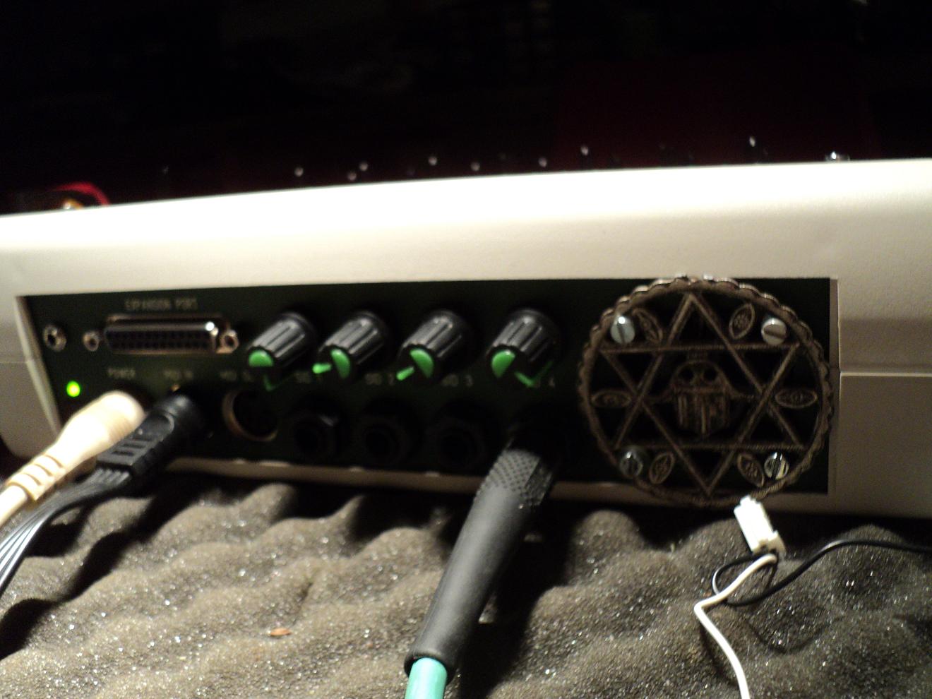

Hi , took a few years but then again learned a lot.
And it stays an amazing synth module 😃
Thnx again midibox communityâ¤ï¸
Psu getting bit hot shown cooled by a cold beer and need to add some knobs
Frontplated was an cnc expiriment on lexan glass.
Kept the leds and lcd under the plate and the engraving well just pressed stop on the cnc machine;)
