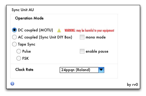

See attached image for a mockup of the GUI in development:

Yeah, am planning to implement that as soon as I figure out how the gui stuff works for Audio Units.. I’m really a n00b in Audio Unit development. All I can program so far is sliders and I dont need any :slight_smile: You can already see the dropdown menu in the mockup of the gui posted above.
