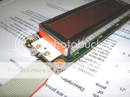

you can change the colour of green ones using thin .5mm  fluorescent
what is called live edge perspex / plexi, the stuff used in displays under uv lights.
it comes in blue, green, red, orange, pink and can be found in art / hobby suppliers.
I turned my green 2x20 lcd into an orange one to suit the theme of the multi sid I’m still building…

Here’s some Pics of my LCD display altered from green to orange as noted in my last posts.
The orange isn’t as strong in the pic as in reality, I used flash on the camera and this seems to go through the screen and bounce off the green backlight diminishing the effect. I’ll post another without flash and try to capture the true effect some
other time.
Can just see the orange.
How it’s done.
                                        Jorge… ;D
