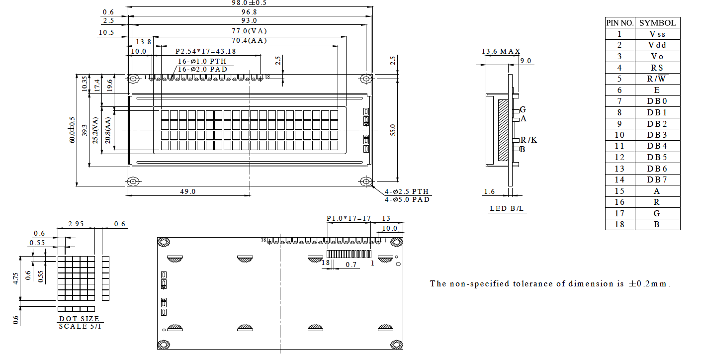

These RGB char displays use 18 pins instead of the standard 16, which means there’s separate power input for Red, Green and Blue.
I posted a pic in the gallery of the approach I took with one of my MB-6582’s.
Basically I was able to use a single pot on a tiny piece of protoboard to send variable power into Green pin.
I sent the full 5v source into the Red pin, then used the pot to mix in a bit of Green and _ voila _, a nice Amber color that nicely matched my LEDs ;-)
