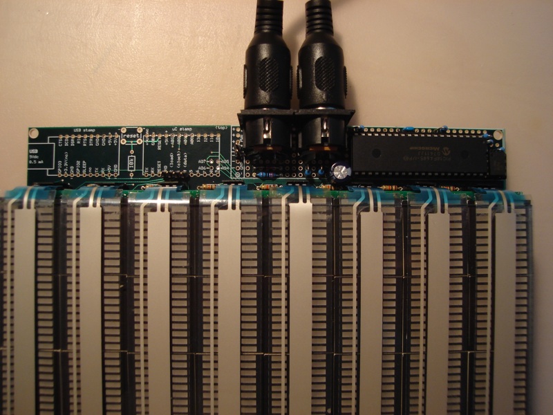

I quickly hacked a MIDIbox based firmware for the Stribe project, and already had a lot of fun with it in conjunction with Reaktor.
The released firmware is available in the MIOS download section
Temporary updates can be found in the Repository
Reduced MBHP_CORE circuit for Stribe board (can be soldered on the prototyping area). The Arduino modules are not required for this solution.
More #1
More #2
More #3
More #4
The firmware is currently running on a PIC18F452, but future updates will use a PIC18F4620 (e.g. for optional OSC support)

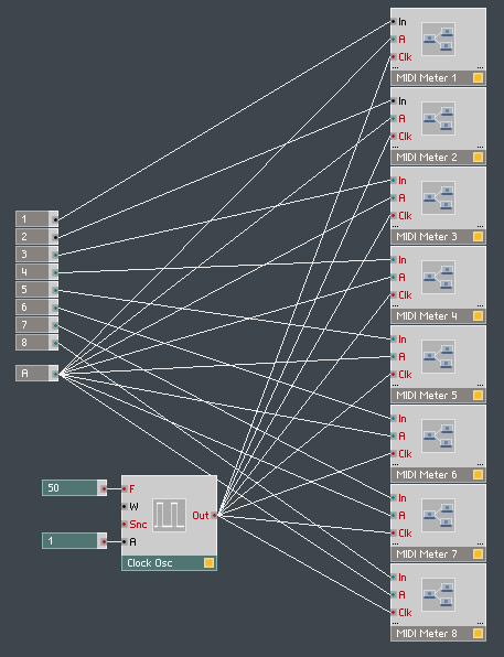

Not sure how those meters are realized. I`m not Reaktor user but it seams more responsive than LC meters! Is it?
Looking forward to read more info about it.
Yes, the meters are much better, because with Reaktor I was able to construct my own “algorithm” :slight_smile:
It basically consists of a rectifier, amplifier, lin/log-converter, slew limiter (to smooth the waveform), sample&hold stage, step filter (events are only forwarded if there is a difference of >= 1) and CC output unit:
8 of these macros are stacked together, and the S&H stages are clocked at 50 Hz to reduce MIDI traffic:
It looks simple, no? :slight_smile:
