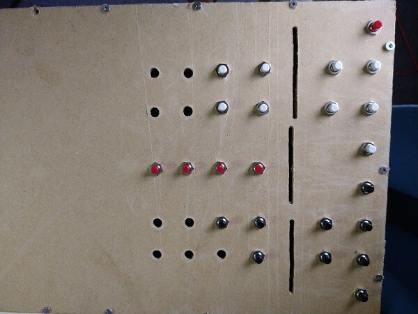

My English is not very good. I am trying to build an electronic stop knobs board. If I press a knob I want a signal to my grandorgue program. Later on I want to connect leds to indicate the state of the button.

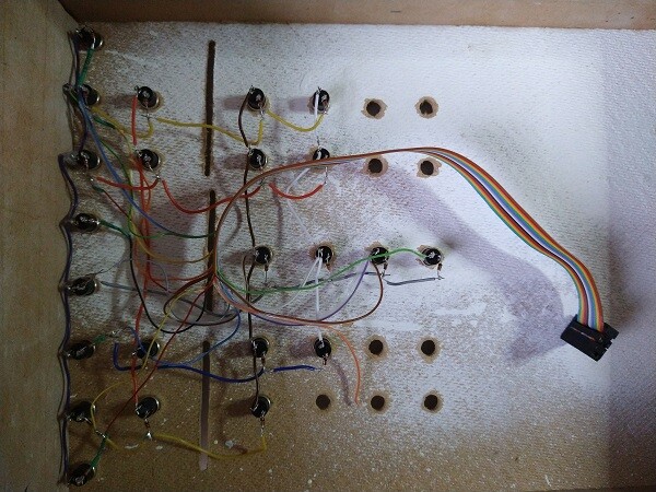

I made board, soldiered the button switch and connected them to a dio_matirix. The lpc17 had an old bootloader with midio128. I succeeded in installing midibox NG. The file “default.mio” was still on the SD card so I deleted it.
The stop knobs (buttons) are not working out of the box. All the column buttons send the same note.

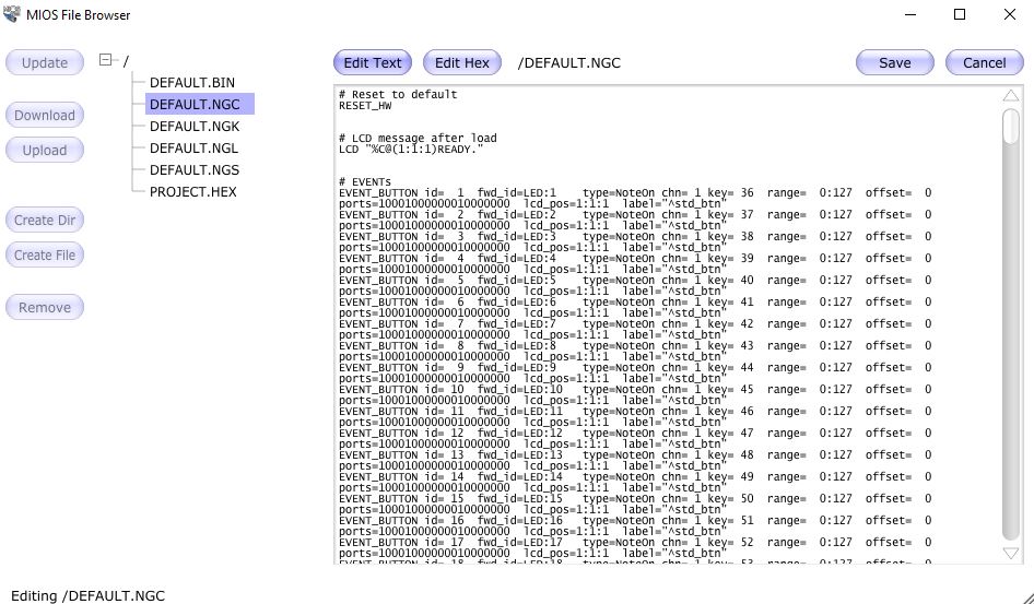

With the filebrowser in mios32 you can browse into your sd and edit the ngc

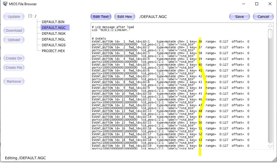

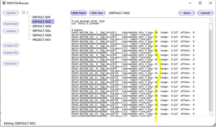

I read the documentation and I studied the default.ngc.

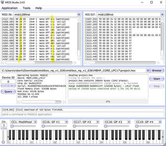

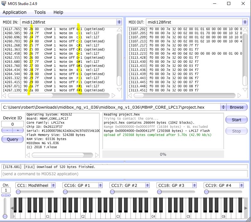

If I press a (knob) button I would expect the folowing results: keynotes between C2 (36) and D#7 (100). This is not the case. All outputs result in keynotes C1 … G1 (24..2b) (only 8 notes).
Why o why?
new idea: I switched on the following in default.ngc:
DIN_MATRIX n= 1   rows=8  inverted_sel=0  inverted_row=0  mirrored_row=0 \
                   sr_dout_s el1 = 1 sr_dout_sel2= 0  sr_din1 = 1 sr_din2= 0
DIN_MATRIX n= 2   rows=8  inverted_sel=0  inverted_row=0  mirrored_row=0 \
result: no output at all when I press the buttons.

I’m no expert but I think your definition is wrong.
You need a EVENT_* in order to send MIDI events.
Try this:
#definition of buttons matrix DIN\_MATRIX n=1 rows=8 sr\_dout\_sel1=1 sr\_din1=1 button\_emu\_id\_offset=1001 #defines which SR to use and the hw\_id of switches from 1001 to 1064 #definition for EVENT\_BUTTON starting from id 1001 EVENT\_BUTTON id= 1001 type= CC chn= 1 cc= 0 range= 0:127 button\_mode=OnOff #this sends a MIDI CC on address 0 on channel 1 when first button of DIN\_MATRIX is pressed

@totoraymond: Well you may not be an expert, but you are a genius!! I made the changes you proposed. After removing the other id entries it worked. Thank you so much!
