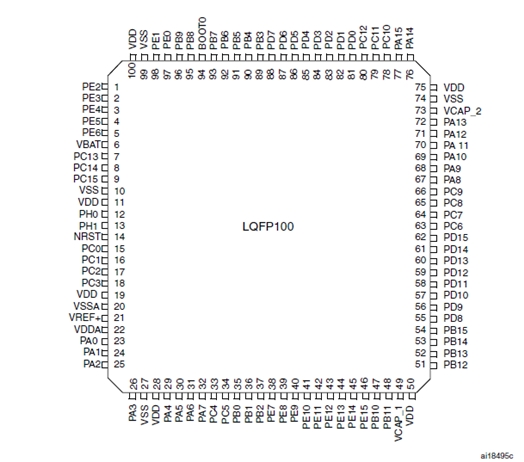

I checked around on the forum and had seen a lot of people having issues with wiring , the card slots and the format on the cards. Mine turned out to be bridged pins under the LQFP100 on the STM32F4 board. Here are the relevant pins if you are having issues as well:
          LQFP100     P1
PA5        30           15
PA6        31           18
PA7        32           17
PB2        37           24
Here is J16 looking down on it

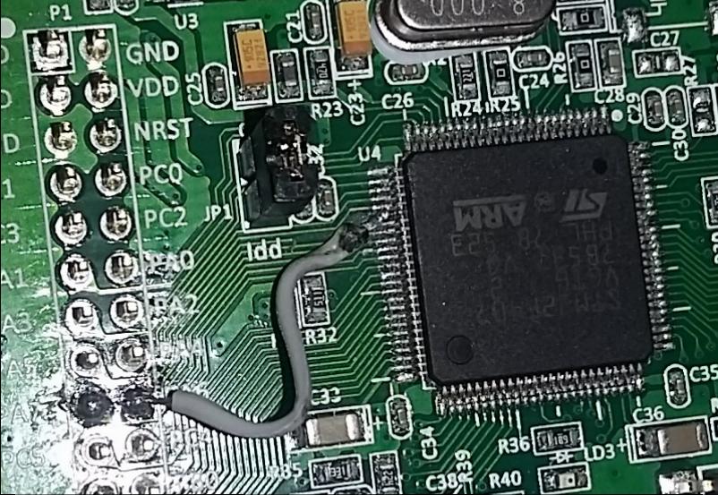

I figured the board was already messed up so I decided to try fixing it. Those pins are super small and hard to work with. There was a dead short between PA6 and PA7 I was able to lift pin PA6 and cut the trace with a razor blade and solder a jumper directly from the pin to PA6. I would think this error would more likely happen from a solder bridge elsewhere and the STM should pass QC. The pins are pretty easy to test as they go straight to the ARM Processor. The also nicely went in order down the side. PA5 was pin 5 on that side of the chip. The white silkscreen on the board makes it a lot easier to keep track of the pins they are marked every 5 pins. The jumper might look a like it is crossing things in the photo but the pin is bent up and out so there is plenty of clearance. I tried solder wik, reflowing the pins, my hot air rework iron, cleaning between the shorted pins with a razor blade,  and even removed the header pins hoping the short was there before lifting the pin but nothing else worked for me.
Good sleuthing! Thanks for the write-up. I hope they’ll send a replacement.
When doing bodge repairs like this you can consider using thin enamelled wire, i.e. “Verowire” or even that used to wind transformers/coils.
Verowire would be a lot better. I was going to use some wire wrap or the verowire but could not find where either the rolls had gotten off to. The ribbon wire worked but is just so big compared to the pin. I debated some solid telephone wire but decided the advantage to the ribbon wire is that it is stranded so hopefully will put less strain on the pin.
 ST said that the processor on the board does not match production to what they install on the discovery boards and that I would have to go back to the person I bought it from. I looked it up and I actually had bought it on amazon listed as new with a gift card. Basically just stuck with it now. It was a bit disappointing ST did not stand behind their product but also understand their point of it being tampered with. Glad I went ahead and fixed it instead of waiting a week or more on their refusal of support.
Yeah, I think some others also had trouble with pirate DISCO boards. But if it works, there’s no problem!
