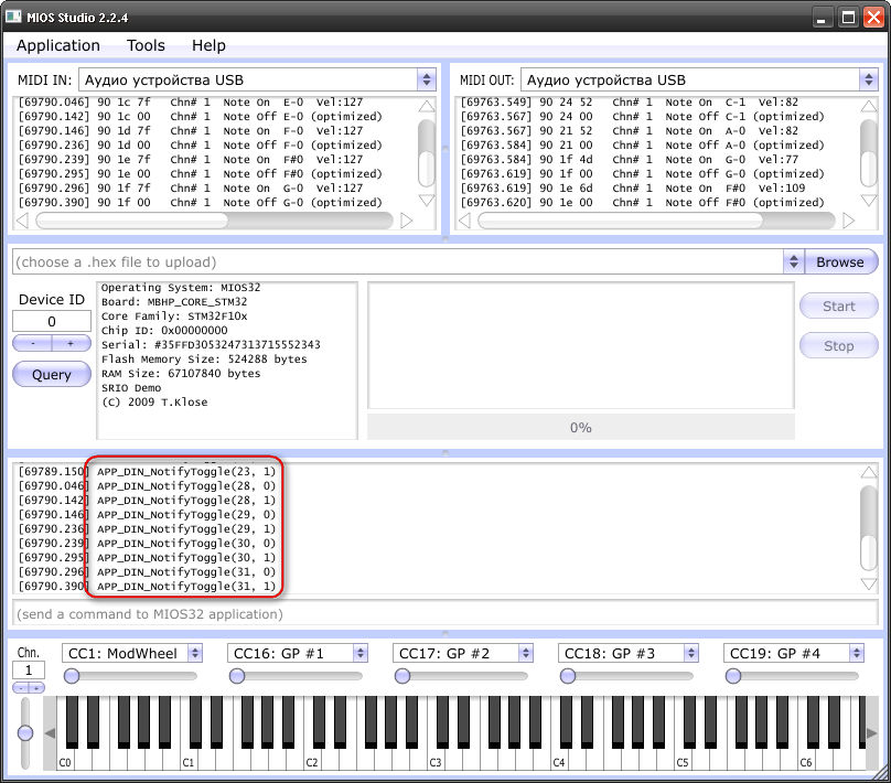

Uploaded your hex to the board by MIOS studio. Everything is fine (I think). But what should happen? When I press buttons on virtual midi keyboard in MIOS studio (at the bottom) - status LED blinks (yes, I connect status LED to the board already). Thats all…

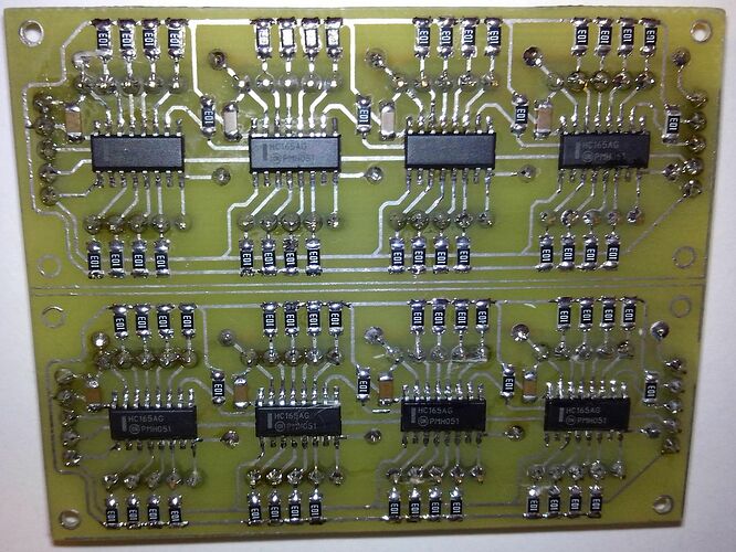

Actually I’ve already done DIN module (not tested yet).

upload the hex selecting MIOS31 port1
In MIOS Studio, then you will change the output port to port2 : if you play some notes on the keyboard, you will see them as data in the Midi out window and at the same time (just 1 or 2 ms of difference) in the Midi In window. then invert the stuff : you output from port1 and receive on port 2
what does the app ? it forwards midi messages from USB0 to USB1 and messages from USB1 to USB0
notice than changing the port will cause a error message : that’s normal as the communicating port with mios studio is Port1
julienvoirin, I was confused, because I had no port1 or port2 at the beginning. Actually I had only 1 USB devise in MIDI IN/OUT…
But after some unplug/plug cycles the second USB device showed up:
But still its name is not MIOS32 port1 or port2 like on your picture.
But it works! Yes it transfers notes.

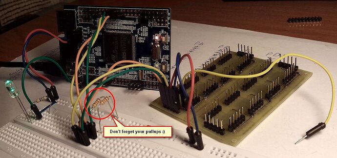

julienvoirin , downloaded svn, toolchain and other stuff, compiled \trunk\apps\examples\srio. uploaded it to a board, but get no response from my DIN module…
Maybe DIN module is not functioning, maybe I need to connect it to other pins on this mcu… Think I need to check if my module working first.
Update: checked DIN module on Arduino board - all 64 (I have 8 x 74hc165) pins reads correctly (on 5 volts and on 3.3 volts) -> DIN module is OK.
So the problem is somewhere else… I think I need different setting of the toolchain to compile apps for this core.
I’ve tried to set MIOS32_PROCESSOR=STM32F103 Z E but get error on make (there is no .ld file for that core).
Update 2: copied \trunk\etc\ld\STM32F10x\STM32F103RE.ld to STM32F103ZE.ld
compiled without errors, but still no response from DIN :frowning:
What am I missed out? I think, that pins maybe different on this core.

Maybe an important hint: check especially if all pull-up resistors are installed on the pins you are using - they are essential, because most pins are configured for open drain mode.
Yep! That was the problem! I was going to use them in final version of the device but totally forget them in testing… Shame on me… :blush:
Added couple of them (on RC and SC pins) and now all is working!
It was actually PB12, PB13 and PB14 pins (like in the MBHP_CORE_STM32 schematic) not the PA4, PA5 and PA6 (like it was said in the README.txt for the “srio” app)! So there is a mistake somewhere.
Next step will be DOUT making (made some PCBs already - need to solder components).
I will share the info about my project when It will be done.
PS: my DIN modules:
