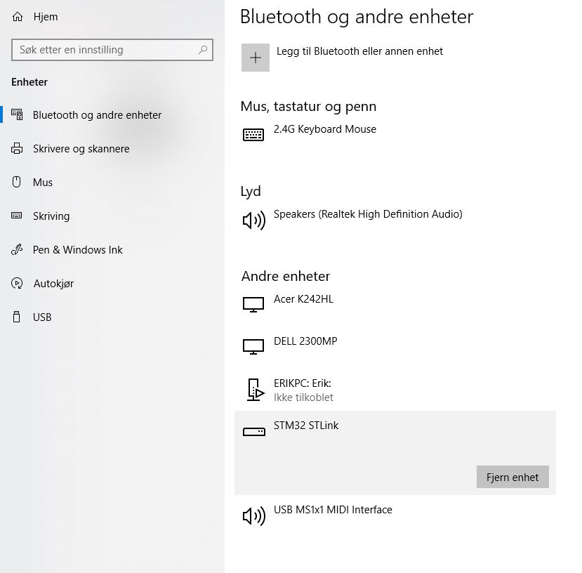

its not being recognized as an audio/other device but as a disk. stm drivers are installed as admin, ive tried both with disk option type stm when upgrading and without. Other midi devices over usb do appear, asio4all installed.
Known problem? It simply wont show on windows so obviously a windows problem, but maybe one someone has solved I hope.

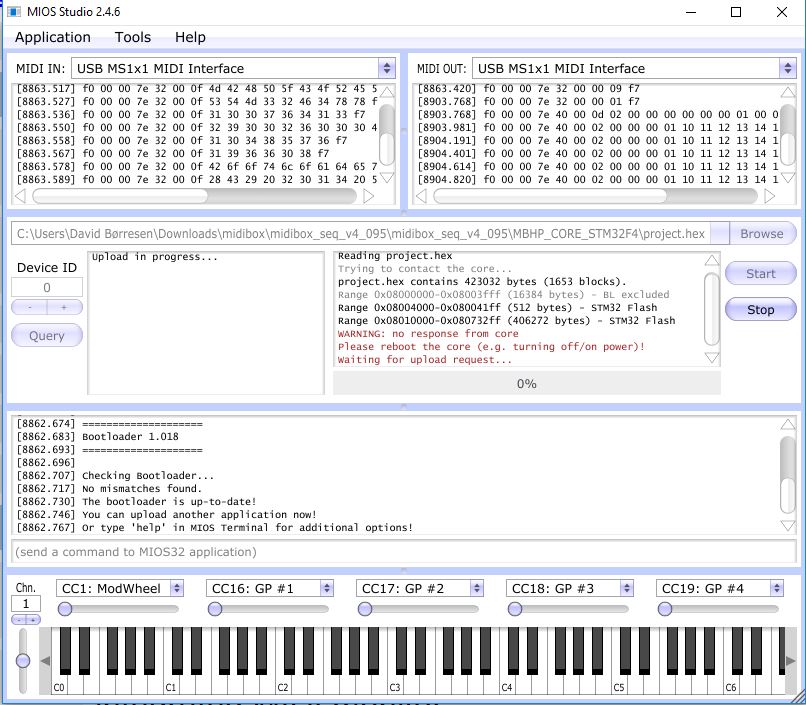

Intstead of relying on usb midi from stm I connected main board and one of the midi cards and got as far as this, where if I just have it connected it is recognized as up to date bootloader, but drops out when programming … or as this while cycling and holding blue button, where it gets no core response.

The problem seems to be that when I press start in MIOS the connection to the core immediatly drops, but after the upload fail (few seconds) it reconnects saying bootloader cant be entered.
Ive done nothing to the settings this time around, but I tried various settings in help(limiting to one midi etc) yesterday. Device ID, name etc updates so theres obviously contact.
Also tried hold blue, press black, continue to hold blue … but then result is that it loses contact until I release blue again (thats the screenshot asking me to reset the core).

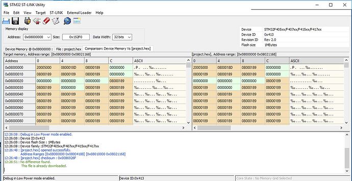

Attached screenshot for successfull bootloader programming. Also finally shows up as STM in device manager.

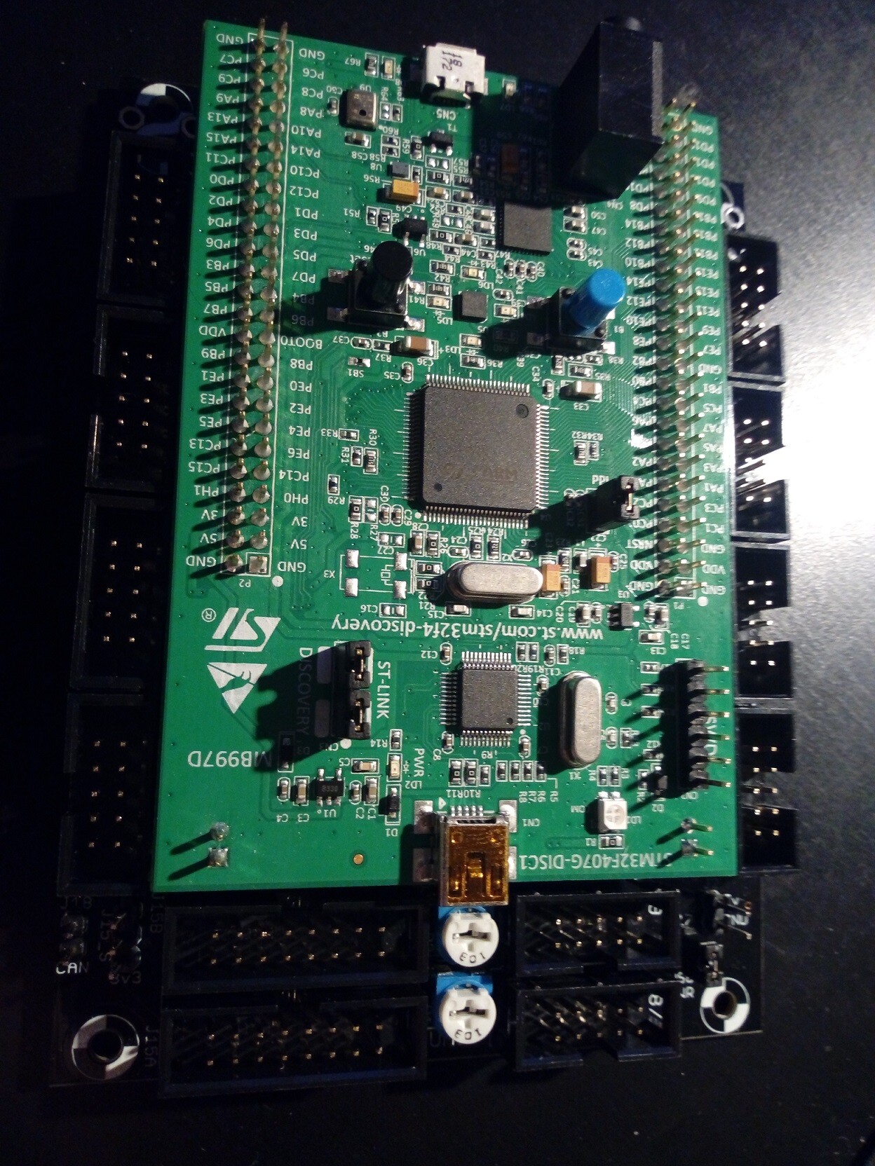

Could you please upload an image from the core-module? Maybe there is a jumper missing on the discovery-board itself?

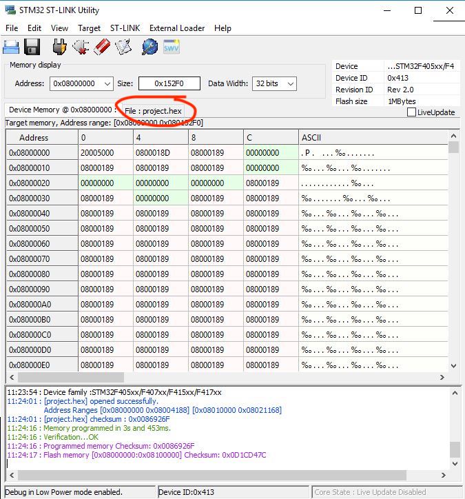

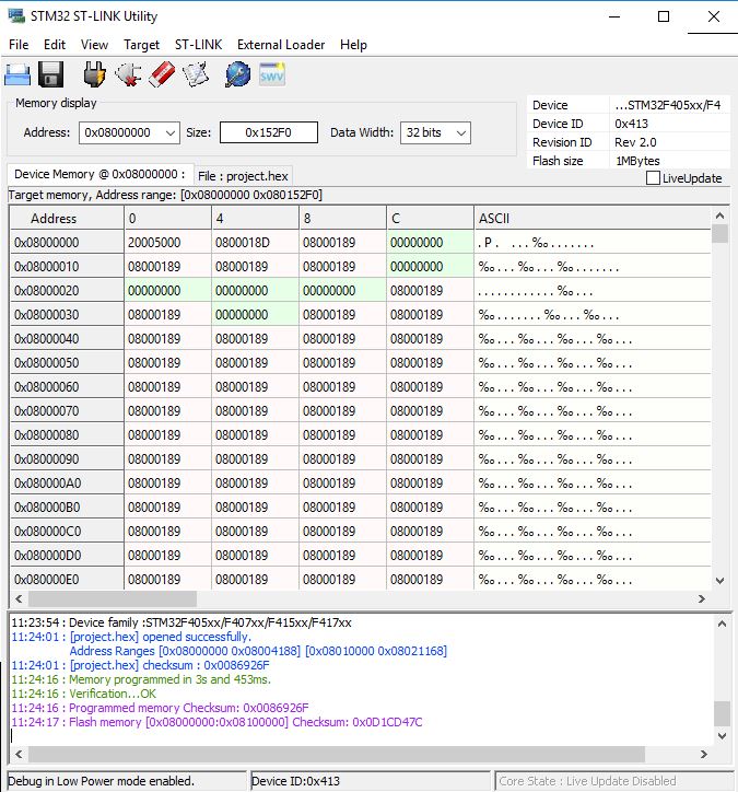

Yep, tried wipe, tried using both bin and hex file. Settings in ST-link as attached (default).

Still inclined to blame windows as I see no midi device from STM no matter what I do.
As for core jumpers J1 on STM as well as the two for ST-link is jumpered. Comparison in ST-Link finds no problem.

You have to upload the project. bin not the project.hex with the ST-link!
Im uploading over USB as in all posted examples, apologies if that was unclear (wasnt really aware ST-link was a dongle programmer as well) … but yes, Ive tried that, no difference.
Sorry it’s project.hex.
