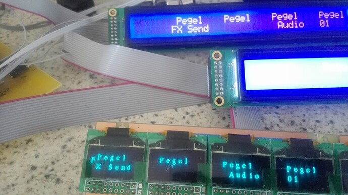

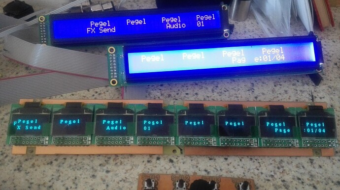

SSD 1306 Oled Problem on LPC17
Problems with the display of characters and letters. They are not right in the lines or even deleted.
I use Big_Font, with thin or normal is everything.
Seting:
# MAP2 lcd_pos = 1: 1: 2
Event_receiver id = 5 type = SysEx Strom = “0xF0 0x00 0x00 0x66 ^ dev 0x12 ^ Cursor ^ txt56” range = MAP2 lcd_pos = 1: 1: 2 label = “& b”

Hi,
the clarification of this issue is still on my TODO list.
Probably it’s related to the way how the Y position is placed at the second line. For big fonts a special case has to be considered, this can only be changed in the firmware, and therefore I guess that I’m the only one who can help here…
Best Regards, Thorsten.
I found a solution to handle the Y position properly if the big font is used for SysEx based GLCD output
Please try this version: http://www.ucapps.de/mios32/midibox_ng_v1_034_pre1.zip
That was fast.
It works SUPER
TK You’re the best.
A Merry Christmas and a Happy New Year
Greeting TOKEN_one
