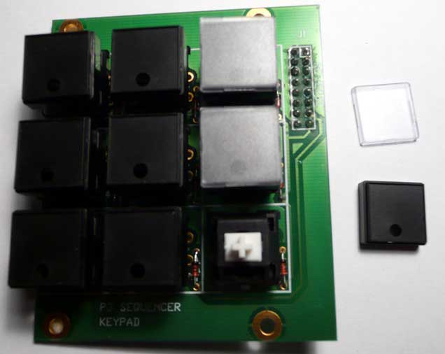

Maplin don’t do those switches any more - they died with ROHS, I think. I was using them in the early 90’s, and I can say that they were not the best I’ve ever used… very ‘soggy’ feeling, and quite fat pins - you’d have to drill out perfboard for them.
On my P3 I used the Cherry switches as reccommended, but bought the ‘Point of Sale’ style legendable key caps from RS. Note that both the switch and the cap have a hole for a 3mm LED. With a bit of fiddling you can get a 3 colour one to fit - just a bit tight on the PCB.
The RS ref for the caps is:Cherry POS key caps
I’ve taken a couple of snaps to show them.
Not as cheap as tacts - button and cap come to about £2, though it’s a quality, long life switch. I’m going to trawl the flea markets for the higher quality Cherry keyboards, salvage the switches, and buy the new caps. This is how I plan to do a Midibox sequencer with 64 button key/lamp matrix. I can print nice symbol labels for the caps with transport control symbols and other custom labels. Printed on film, with a colour inkjet, and white LED’s, you could get quite fancy, a bit of baking paper or tissue can act as a diffuser for the LED.
