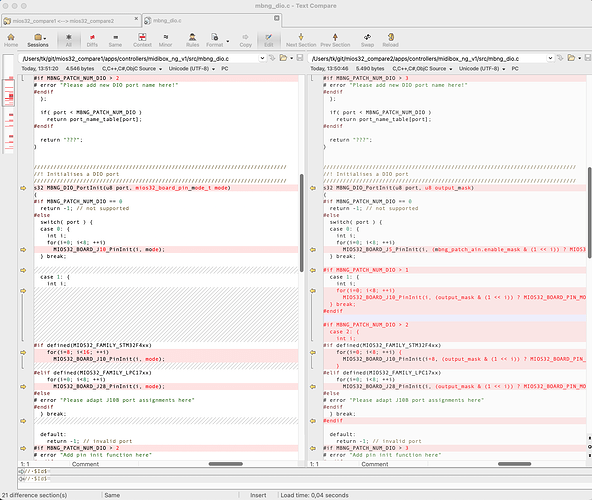

Hi Bartosz,
the entire history is in github, which means that in your downloaded repository you could switch back to the sources which were used for v1.036
The appr. commit was 6edfcd51ad6cb78f83d6094c5c9d1b7c5b85ddb3
So, just enter “git checkout 6edfcd51ad6cb78f83d6094c5c9d1b7c5b85ddb3” to switch back.

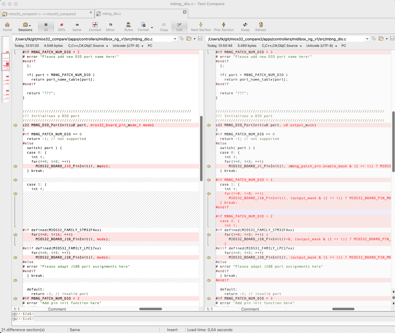

There are also ways to compare the “good version” with the latest one, e.g.: https://github.com/midibox/mios32/compare/6edfcd51ad6cb78f83d6094c5c9d1b7c5b85ddb3..master

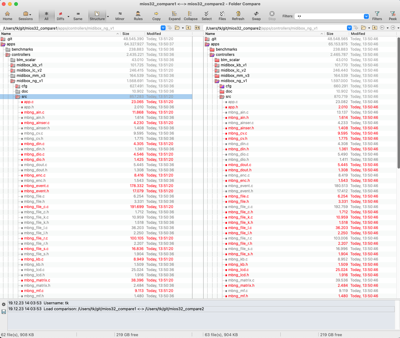

Or you could clone the repository two times, switch one to the good version, and then use a diff tool such as “beyond compare” to analyze the changes:
Best Regards, Thorsten.
