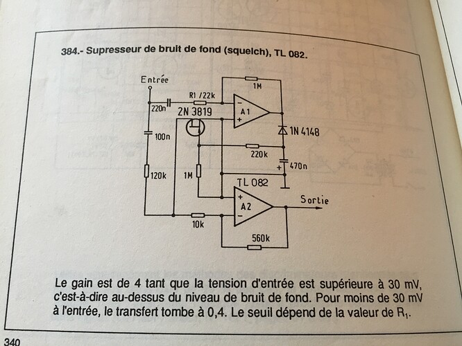

I found this schematic in an old book, this is mono but you can maybe use 2 circuit in // and a TL084 instead of two TL082.
Best
Bruno
PS: tell me if you need translation from french.
thx, but therefor I haven’t the negative VCC– for TL082 or TL084.
I search a solution, where I can reuse the 9V~ or 14Vdc or 5Vdc of C64 optimized PSU schematic.
