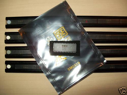

Date code of 0511?
The seller is an experienced, well known and respected Commodore dealer, supplied with a 30 day warranty so if all is not as it seems there should be no problem.
S
Date code of 0511?
Obviously those chips are going to be produced in February 2011, so you might have to wait for them a little bit :wink:
Unless there’s some secret marking theme I don’t know anything about, those are remarked - which isn’t really an issue. But if they’re remarked, the seller sure as fuck doesn’t know whether or not they’re “from the chinease batch of plastic/remarked/homemade chips that appeared last year” or if they’re really not pulls.
Obviously this doesn’t mean they’re fake or non-working but it would mean there’s something a tiny bit odd going on. Which seems to be kinda normal when it comes to SIDs.
Just my 0.02 EUR.

February 2011
How about May 2011?
S
I asked the seller about it and this is his reply:
“It is the batch code and not a datecode (after all it cant be made in week 5 2011!) They are not remarked as they have come out of a sealed MOS box of 244 sid chips. I have listed the first batch of 50 to see how they sell.”

I’ve never heard of SID’s with batch numbers on the top, instead of a date code. That doesn’t mean they don’t exist. But, it does bring some concern. I sent a question to the seller inquiring on a photo of the underside of these chips to see the markings.

Yeah, I would hate to see a legit dealer in vintage electronics get burned by scrupulous suppliers. I sent a note via eBay asking if the seller would post a photo of the markings from the underside of the chips. The response was “we will end the listing and relist with the picture.”

The colour of the marking too is something i’ve never seen before.
Would be cool if they are fully original, and GOLD EDITION 6581s!
FACT: This seller DID sell new old stock 6582A SIDs in the past, with the same datecode as the stock I sell.
HYPOTHESIS: He probably got them from the same broker I got mine. The broker did tell me they supplied some 6582A stock to the UK, which coincides with when this seller was selling 6582A SIDs.
FACT: I have NEVER seen an example of datecodes on GENUINE not-remarked SIDs being inaccurate. On remarked SIDs, they are wildly inaccurate because someone has no idea what number should be there, so they either copy a genuine SID, or make it up. Sometimes they even get the part number wrong.
HYPOTHESIS: SIDs marked with a datecode of “0511” are MOST LIKELY remarked, despite looking genuine and purchased in “tubes”. Of course these remarked SID suppliers are going to ship the SIDs in tubes, and they will look very much like genuine not-remarked SIDs, the pins will be straight and made shiny, the labels reprinted. It’s not totally impossible that some 6581 SIDs with “0511” datecodes were produced, but why only 50 or so?
FACT: People have been buying up all the “new old stock” of SIDs, both 6581 and 8580, for over ten years. It is highly unlikely that another couple hundred SIDs have been found somewhere and only recently been put on the broker market.
HYPOTHESIS: Any large quantities of “new old stock” SIDs are most likely remarked pulls.
I AM NOT suggesting this particular eBay seller is dishonest… these SIDs were probably sold to him by some shonky Chinese broker as “genuine new stock” and they probably look better than the remarked crap I’ve seen so it’s not immediately obvious that they’re remarked. I got suckered into buying some remarked stock before, as you can see from the photo. I also didn’t believe they were remarking 8580 or 6582A but I was wrong. I took a loss on that deal, and managed to recover some of the money through my usual broker physically bringing the crap chips back to the vendor and getting a cash refund, not including the courier costs for the shipment. These brokers who sell remarked chips are total assholes. They KNOW they are selling remarked chips, and then stall on refunds, start a new company, and also typically only deal with companies outside China, so they can get away with this shit without any consequences.
