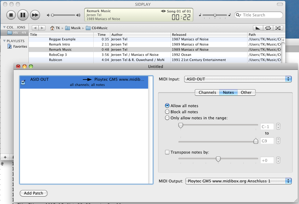

SID tunes are played as usual, but in addition a virtual MIDI port will be opened (called “ASID Out”) which has to be routed to a physical MIDI OUT port, e.g. with “MIDI Patchbay” from Pete Yandell as shown below:
Link to MIDI Patchbay:
http://notahat.com/midi_patchbay
