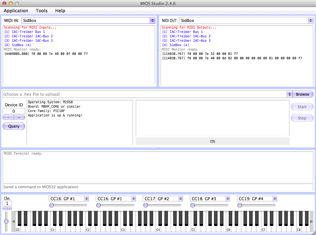

this is my screen when starting mios studio (indicating “everthing is fine”):

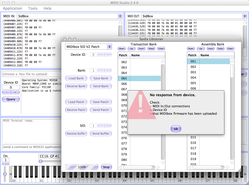

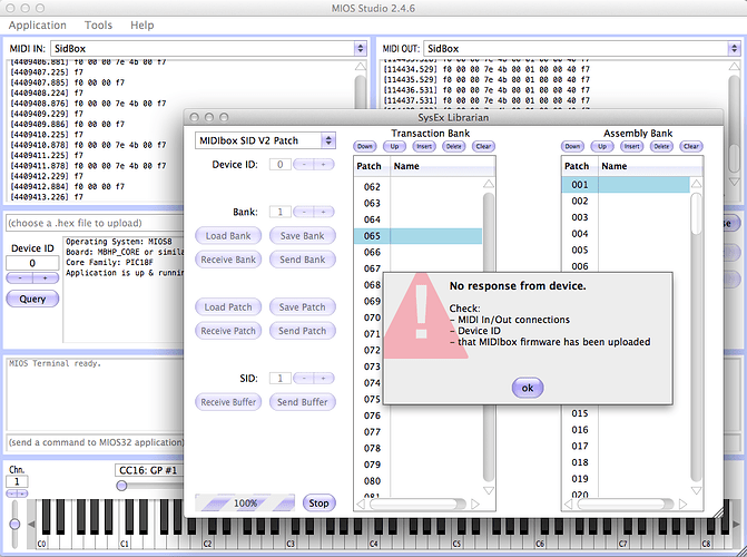

but when i try to receive Patch A065 (or any other patch) from the sysex librarian, i get this error:
trying to dump the same patch from the control surface also sends
f0 00 00 7e 4b 00 f7 f7
