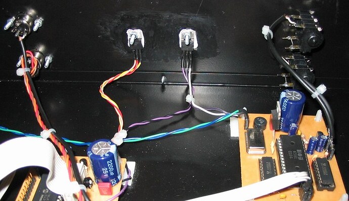

I´ve got some problem with noise level on my new SID. Because it has only one SID inside I chose to build it with a wall wart PSU and put the in-between 7809 and the core 7805 on the back wall for cooling.
When I connect the encoders to the DINs, I get digital hiss (the more encoders are connected, the worse the noise gets). what´s strange: the hiss does not occur while the encoders are not mounted on the (alu) front panel. I can´t think of a way to mount the encoders isolated from the panel or the panel isolated from the case (19"). Is there something I can do against this noise? I already tried to put capacitors across the DIN 5V supply - no effect.

I meant the 7809 that is before the 7805 of the core like in
http://www.ucapps.de/mbhp/mbhp_core_power_fix.pdf
here´s a picture of it:
as I used the cam anyway, here are two more of the beast :slight_smile:

I didn’t figure out from the pics, how those two large  supporting legs, connected to
chassis of the encoders
are connected? To the ground with separate wire, or getting ground connection from the case? A possible ground loop here :slight_smile:

I didn’t figure out from the pics, how those two large  supporting legs, connected to chassis of the encoders are connected? To the ground with separate wire, or getting ground connection from the case? A possible ground loop here :slight_smile:
The encoders are connected exactly like in the schematics by TK. One DIN connector goes to 2x2 “signal pins” of the encoders, the ground pin of the DIN connector goes to the ground pins of the two encoders. I have made no connection between the ground pin and the chassis of the encoders or the supporting legs. I also checked that the encoder chassis is not connected to any pins of the encoder (Alps STEC 16) by default. So theoretically there can´t be a ground loop with the encoders. The chassis has no direct connection to any part of the cirquitry.
Could the voltage regulators be part of the problem? I already had to eliminate a ground loop between the regulators and the power jack - the back part of the regulators is connected to their middle pin so the power jack had to be mounted isolated(ly?).

Do you have still the noise, when the regulators are not mounted to the chassis ?
No ?!. The chassis has ground connection via the regulators.
Another test: Do you still have the noise, when the display is not connected to the core ? - This just to eliminate any connection from the LCD to the chassis.
What happens, when you connect the chassis of a mounted encoder to ground ?

I think we have some misunderstanding about names - you used the term “chassis of the encoders” so I used “chassis” for the outside of the encoders, didn´t mean the case of the whole synthesizer.
I already took the back wall of the case off so that only the two regulators had connection to the back wall. Interesting: the sound varied with the distance of the back wall to the rest of the case…
Now I solved the problem: The noise stops when I take only one of the regulators away from the wall. Probably the small loop around the two ground wires of the regulators is closed through the back wall and acts as an antenna that picks up digital noise induced to the case by the proximity of the encoders. I still don´t totally understand this as there´s no direct connection from the encoder pins to the front panel, but the metal “chassis” of the encoders seems to help transporting clock noise to the front panel.
Anyway - I will put the 7805 back on the core and give it a small heat sink - hope it doesn´t get too hot…
