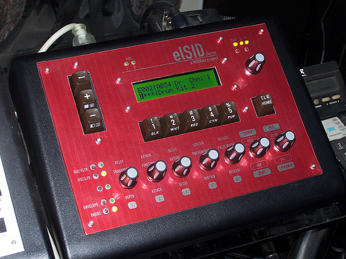

Check my mbSid stereo version, for me it was a good compromise between no CS and full CS(still needs a lot of code mods for the CS to work 100%) the whole CS is made on 3 diy boards, the harder was the one for the c64 keys + 1 stripboard for the top right encoder and leds, add to that a 4xDIN, 1 core, 2 mbSid modules.

Hey, is this already the final pic? The panel looks more beautiful than expected from the first pictures!
Definitely a reference design for small & still ergonomic solutions :slight_smile:

Your setup is pretty low key. You had to use a DIX4x? This is interesting, I may want to do the same.

thanks TK, yeah you may say it is the final pic, not totally sure about the panel, maybe I’ll order one from FPE. i’ll post some more pictures after all the code work is done to call it 100% functional :slight_smile:
napierzaza: I used a 4xDIN cos I had a module from smashTv already, so there are some unused pins hehee, and about the panel it’s all diy, it just takes a lot of patience and tools… and not so perfect if you look more closely, .
