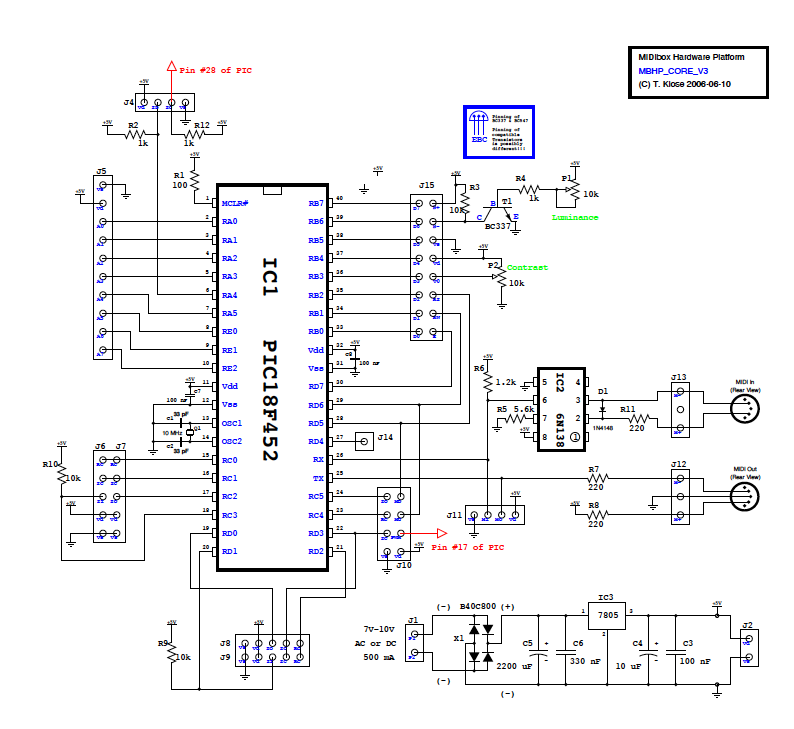

No big deal. It’s the same thing with all the stereo SIDs. You need to connect J14 of the second SID module of a Core to the additional input of the SID. I show you but you need to figure it out for the mb 6582.
http://ucapps.de/mbhp/mbhp_8xsid_c64_psu_optimized.pdf
I don’t have on, already, if I had one I would describe this more precise but this is how it should work.

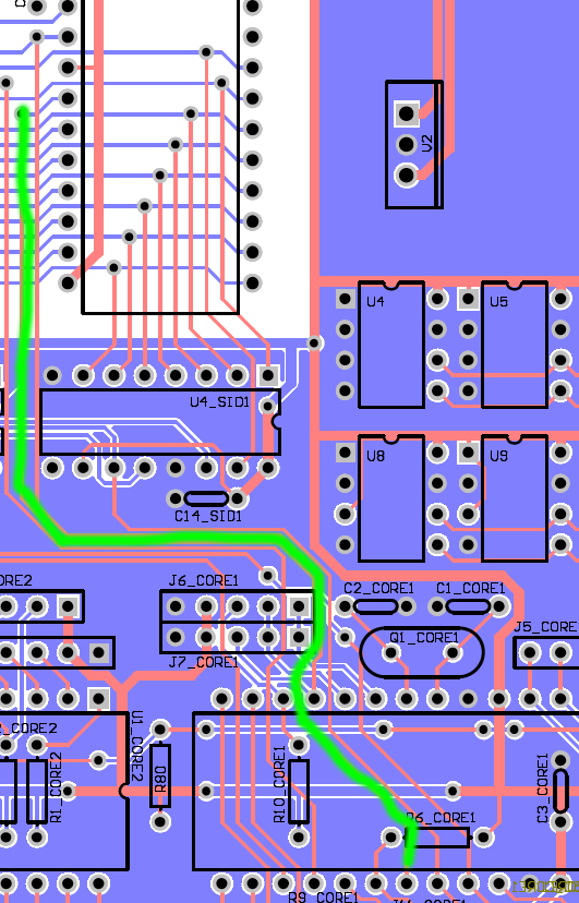

Doing a little digging with the mbhp_core_v3 schematic, I can see that J14 should be accessible from the PIC’s RD4 pin:
http://www.ucapps.de/mbhp/mbhp_core_v3.pdf
Following the relevant trace on the base PCB schematic shows this:
http://www.midibox.org/dokuwiki/lib/exe/fetch.php?media=mb-6582:mb-6582_base_pcb_r2_color.pdf

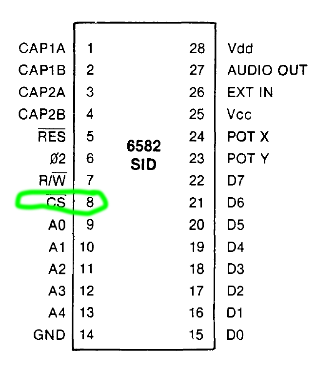

Which is tied into the CS pin of U2_SID_ x _ :
http://archive.6502.org/datasheets/mos_6582_sid.pdf
Would I need to reroute this to make an ARM2SID pair work in U1_SID1 and U2_SID1 of my MB-6582?

What I would do is,
take a precision socket or just a pin from a precision socket and solder a wire at it. Put the socket or the pin into the mb socket.

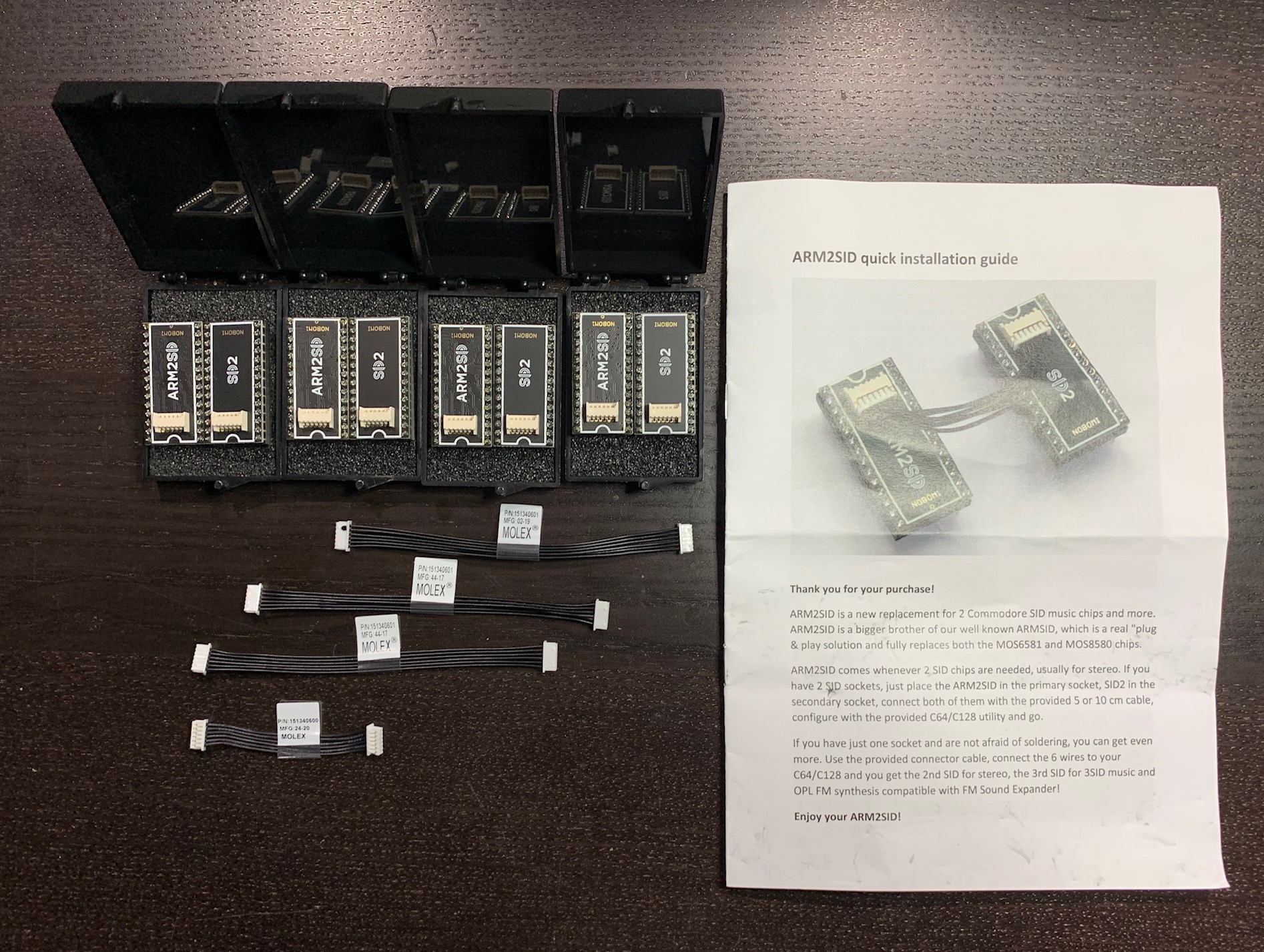

Guess what showed up in the mail today, fresh from the Czech Republic?
Sound test soon…

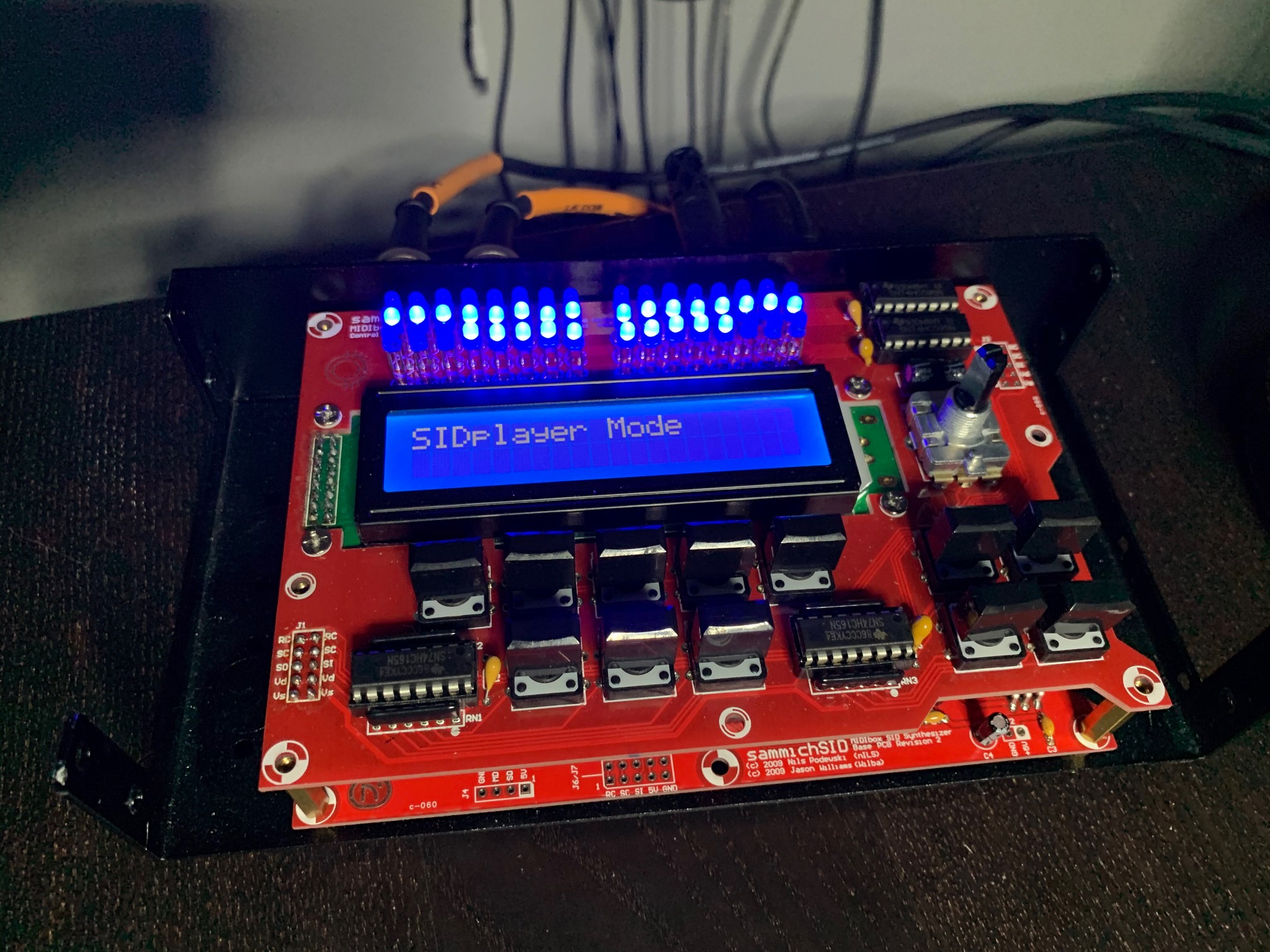

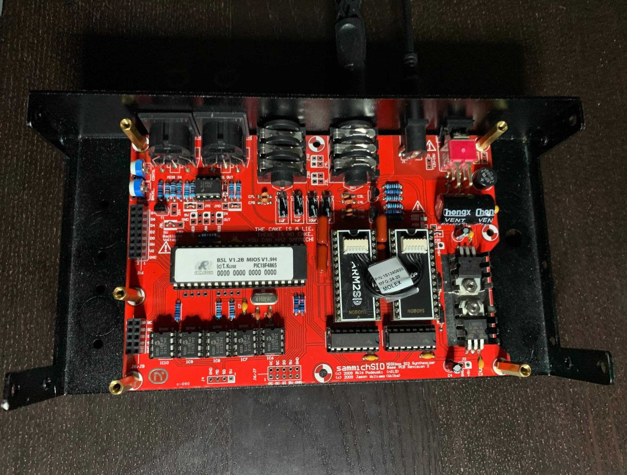

I finally found a little window of time to plop a set of ARM2SIDs into a MIDIbox SID to play with some patches, and… _ WHOAH _…
In my humble opinion, they perform exceptionally well.
I tested them with default configs (i.e., dropped them into a MIDIbox SID with no config changes), and can say that they combine a very low noise floor (e.g., nonexistent), and produce very accurate SID sound emulation, with reliably consistent volume levels, across all voices and various patches (So, Win -win-win… ).
The price-point for an ARM2SID set is ~$48 USD, which is a bit more expensive than purchasing 2 * SwinSIDs (which avg. ~$15-$20 each on eBay, or $30-$40 for a pair), but ARM2SIDS sound very accurate and produce consistently powerful output levels, irrespective of the patch chosen.
