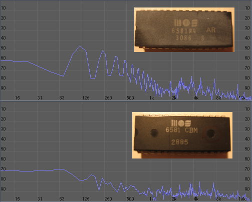

Shocking (to me at least)
So much for R4’s superiority!
There must be something that eludes me here. I had my CBM (r3) MIDIBox sid for a while,
then decided to look at what other SID i had in this c64c i found in a recylcing facility for 2$..
It had an R4 in it, Yay i says, lets swap it…
These shots were taken right after a program change in both cases.
Is there a solid link/comparison thats been made across chip revs/dates etc?

i woke up at night and remembered that my particular MBox SID hums when ask too much current,
say i boost the LCD’s brightness (it even reboots the pic) so maybe this hum was just caused by the
R4 sucking more juice?
You need a better power supply. It’s coming out of regulation, or tripping the current limiter in the regulator.
Mike
Mike
Im using the smashtv’s kits with included parts.  Could it be the transfos?
iirc they are 500 or 600ma (will check tonight)
There’s your answer…
